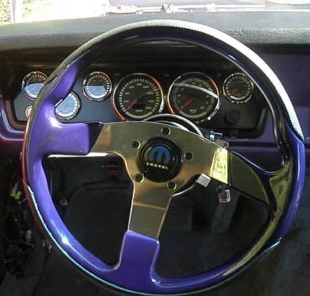

So first you need adapter hub with correct spline fitment to your steering column. Most common and available is Grant and it will have a bolt pattern for Grant steering wheels. Then you can choose most any brand , any bolt pattern, wheel you want. You'll go to Amazon and search the adapter from Grant to that. Mine is Grant to MOMO. I think its 1 inch thick. That thickness figures into the depth of the wheel you choose, how far the wheel will be from you. My wheel is quite flat, and small diameter so I too altered the signal wand.
