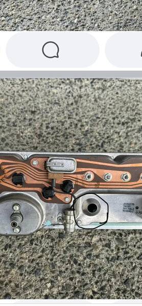

I have a 1972 Plymouth Duster 340 4 Speed - Non-Rally Dash. I am missing the light bulb holder for the seat belt warning light that plugs into the back of the instrument
cluster, a prior owner removed it. I found the Blue and Blue wire with a White stripe and tested the wires. I am looking for the grommet or plug that plugged into the back of the instrument cluster. Any help where to locate one or a picture of what it looks like would be appreciated.
Pretty sure this is it. Can’t confirm until the weekend when I can compare it to the one in my 72 dart. The bulb below is an 1895 bulb.
Wow, thank you. Looks like the blue and blue/white wire attaches to it. Thanks for confirming the bulb too. I will have to find the bulb socket to wire Into my harness. I really appreciate your input!
