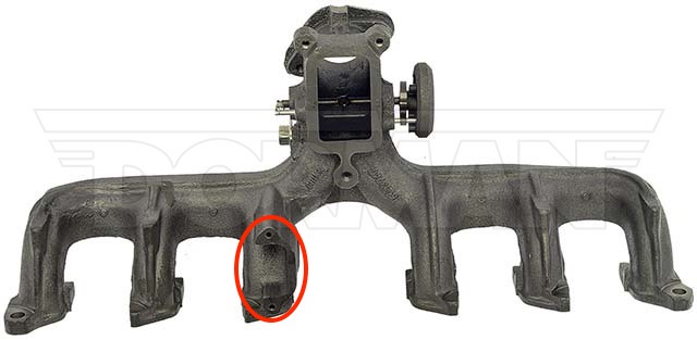

The manifold I now have doesn’t have it.
So am I screwed? I put a reman carb on!
So you're saying that the circled part is missing from your manifold?
You could get this electric choke kit from eBay, but it requires the screw holes in the manifold to fasten it, if not the actual well.
Or do you mean something else?

I could swear on my old manifold that was OPEN. I have that fitting and the other stuff that was in that hole was rotted out.
I thought the carb was a potential issue. The old one has a core charge but I have NOT sent yet.
Shouldn't be. It's just a cast-in bowl.
So you need the proper choke spring assembly. They vary by year, so make sure you get the right one. Or get the electric choke linked above.
Some of the early 70s model choke stoves WERE open to the exhaust. @slantsixdan was just confirming this recently. Just use an appropriate choke stove for that recess and your choke will work fine.
The '70-'72 exhaust manifolds did have an open hole at the top of the choke tower on № 5 runner. That setup is problematic (exhaust leaks from a no-longer-available gasket, etc). All the new manifolds have the '73-up style of cast-in pocket at the top of the choke tower. Put on a № 1231 electric choke kit and you'll be all set with a better-than-factory, fully-adjustable choke.

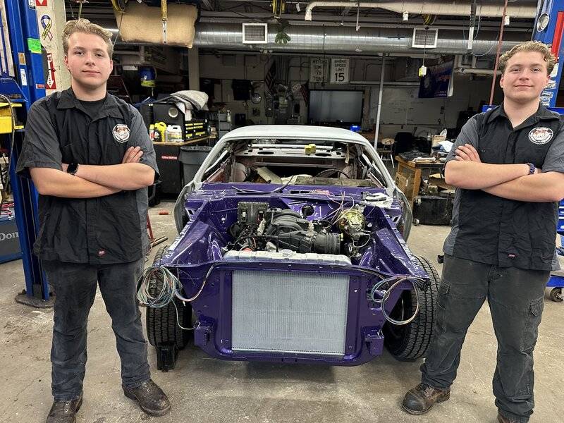

Yes! I am the teacher! We build a classic car every year and raffle it off! The purple one is the raffle one
So "Spartan" probably refers to your school team. Narrows it down to about 12,462 US schools.
And I bet none of them make their students spend a week in the wilderness, alone, naked, and having to hunt for their own food.
My ol' man was a shop teacher and AP for over 30 years, but just after he retired they cut out all the shops and that was the end of that. I knew all the teachers, so back in the '80s and '90s I could just drive up any time I wanted, use the lift, line up my wheels, swap some tires, no stress.
Shame it's all gone now...
Looks like your guys do great work!
– Eric

I have 2 seniors that are really looking hard into opening their own shop!
They are really good kids. Best of all they are twins!
Ah, yes, the old "I'll study the first half of the semester, and you study the second half, and we'll go to the bathroom in the middle of the test and switch seats." :-)
