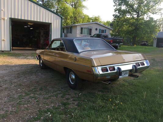

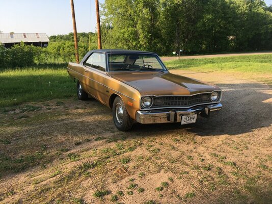

I added pictures of the car after changing out the leaf springs and spending 6 hours buffing out the paint.
