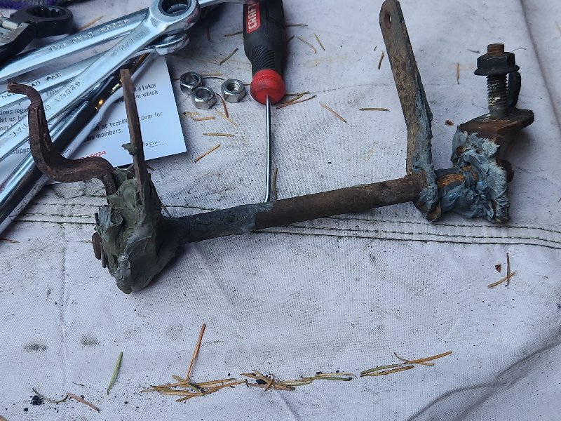

I had to fix the throttle return springs as they were not strong enough to return the throttle all the way back. Since I built the cable bracket holding the lokar throttle and kickdown cables, I had concluded that I must not made it far enough back from the throttle plate, as such I drilled a small hole on the upward facing edge forward of the original spot that the springs currently used. After moving the springs forward to the new hole (about 1/2 in), now the throttle returns back properly. The picture below is prior to the new hole being drilled.
