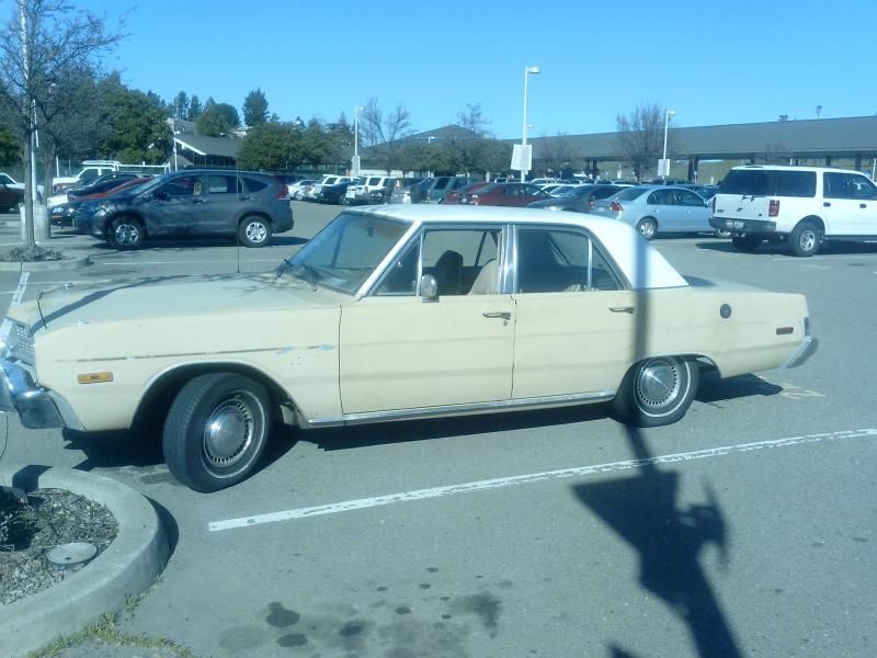

1974 4 Door Dart Clean Up
Serj22
Feb 14, 2013
1,231
61
Benicia, CA East Bay
Well, I went to go buy another 4 door Dart, and was intending to part it out to the 68, but then the girlfriend wanted a cool car. She fell in love with it, and refused to get out of it the night I brought it home. She sat in it with her laptop, and stayed there for a few hours.
So I guess it's getting cleaned up and kept. It's a "nice" high option Dart Custom.
It has power steering, power brakes, discs up front, A/C and an AM radio that still functions; driving it is a 318 that's seen some use, but still runs pretty well. It burns a small amount of oil and the power steering seal leaks a bit, but other than that, it's a good car. It has been neglected though for what seems like its whole life. There's also a nice 8 1/4 rear in the back.

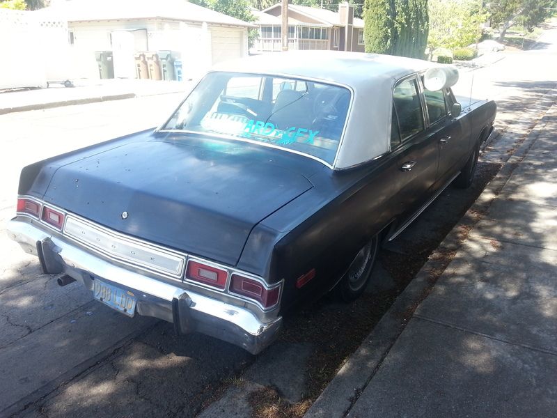

The owner before me already did the upgrade to HEI and did it well - heat sink against the unit too, as well as a high output alt. I bought it over in Tracy and made the drive back to the bay area without a single hitch, and drove it around the rest of yesterday and today. No issue.
It's seen better days, but she'll be nice again.

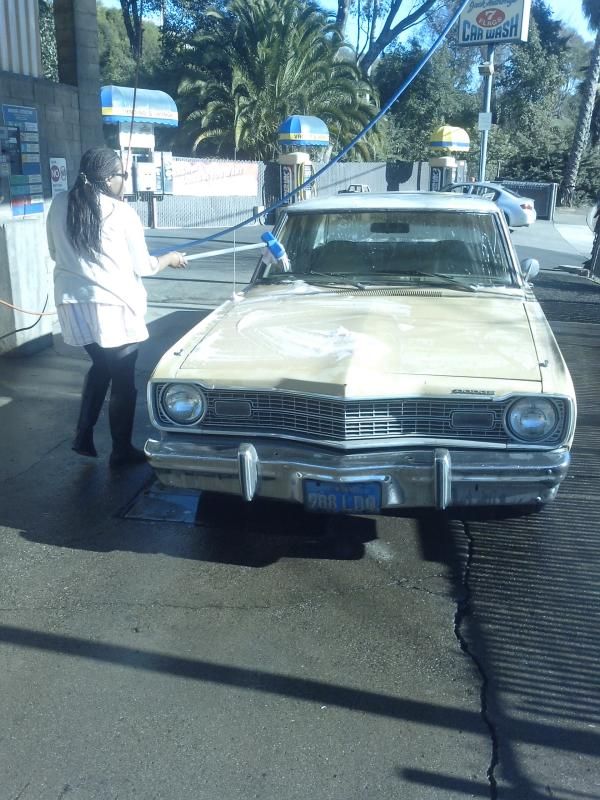

He mentioned the previous owner before him spray painted the roof white after he took the vinyl top off. That was apparent, and when water got on the roof, loose white paint washed down the back of the car.
So we took it to 7 flags and she scrubbed the piss out of it to get whatever else off of it. The water rinsing off the car was just black and brown.
We finally had the whole thing cleaned off, and all the loose white paint fell off. We took it home and i got out my nicest brush, some spot glazing putty - for a couple tiny tiny scratches in the metal, and then went to work. I got a nice white gloss brush coat on, and got another one on this morning after a quick 320 sanding on the previous coat. It looks nice enough, and after about 6 or 7 coats I'll 2000 gritt the whole roof, and then polish it out to one nice smooth finish. I utilize this method to paint engine boxes for boats, and they wind up pretty damn clean, and you'd think I sprayed them.
The engine bay was mostly just filled with dirt and grime. I didn't want to risk gunking it without knowing all that's going on with the electrical system, so we got out a ton of hand wipes and paper towels and went to work. We're about 25% of the way through the engine bay.
The idea behind this build is to not spend a butt-ton of money on this car, but wind up with a nice looking and working driver. There's no performance modifications in mind, as she's not into it, which is fine. It makes the 318 acceptable. I can have my fun in my turbo slant.

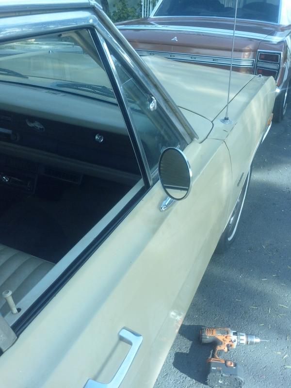

That's the other thing - she couldn't really get over the fact of how used to mirrors she is, so for a temporary resolution I found a $10 mirror at Pep-Boys and mounted it so she could see. It doesn't look awful, and I'd rather drill two holes in the car than have her crash it because she couldn't see something.

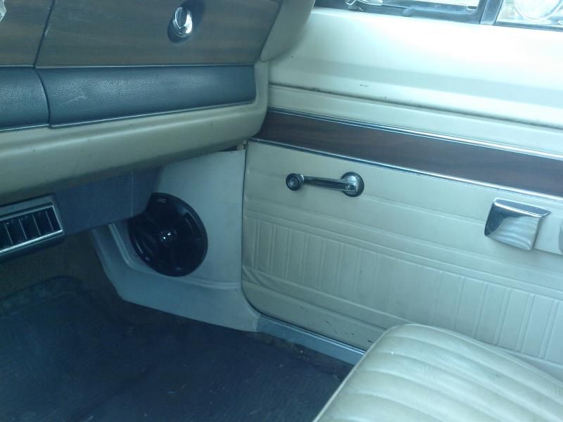

So that's done, and I wired in a modern radio and mounted it under the A/C. I'd rather not cut up the dash as it's in pretty nice shape. Ill run speakers similar to the hidden speaker brackets I have in my 68 Dart. They'll be mostly invisible I'm hoping.

I finished the lower radio install, and hid the speakers into the kick panels. They look nice, and out of the way.

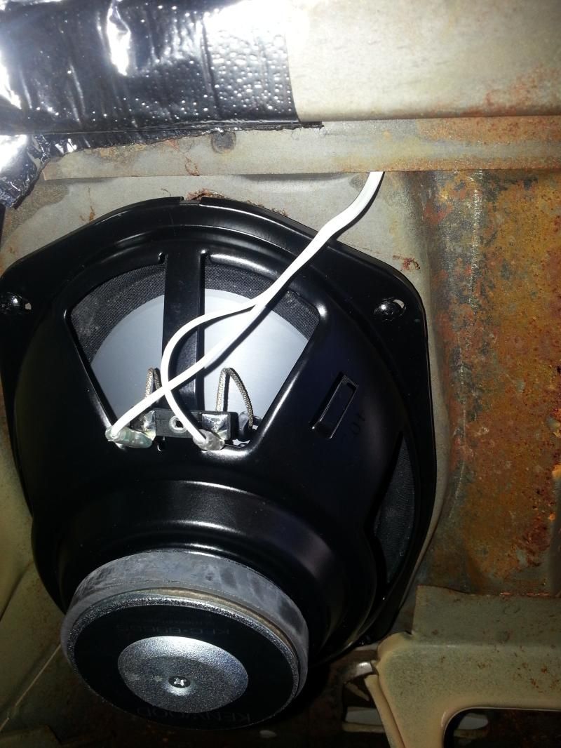

I got some 6x9s wired up under the rear package tray. I cut out the insulation near them and cut a nice + pattern of holes in the tray so the speakers could sit underneath it. I didn't want anything too obviously worth taking, even though they're only $40 speakers - under non tinted glass.

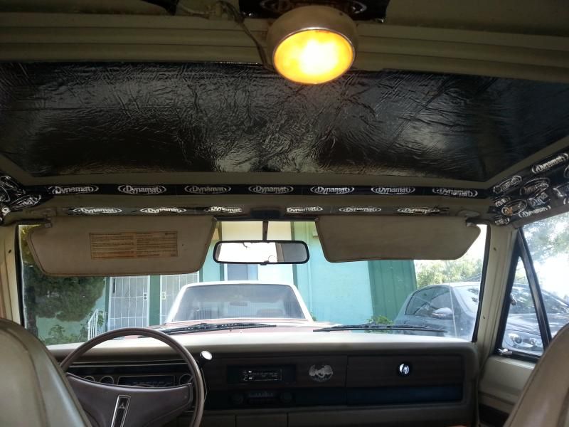

I also got some fatmat and dynamat up on the ceiling, this cut the echo out entirely till I can afford to find a headliner - I'm leaning towards the modern ABS conversion rather than the bows for this car, since it has to be kind of rugged and durable.

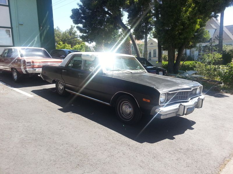

I welded a couple nails onto the front right fender on a nice bowled dent, and pulled it pretty easy with some vice grips and a hammer. Then I filled what was left, and glazed it. Worked out ok. Then I primed that spot and kicked the paint off of everywhere else on the fender down to the gray primer, and then brushed on some thinned out Satin black. I did it like I usually varnish a boat, all strokes in the same direction. It turned out pretty nice looking. I just did the one fender, and it took about an hour for just that panel to cover it.
It came out without the blotchyness that a rattle can job would have, and I think it looks alright. I got a run near the dent I fixed though and I'll need to kick that down and do another coat, otherwise it was flawless... :banghead:

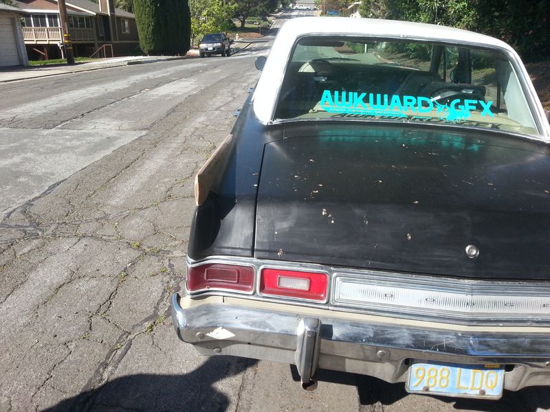

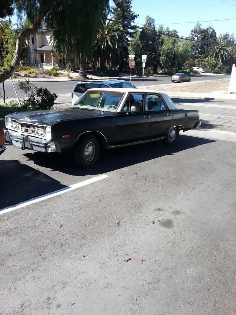

Well the car's been "blacked out" for now. It looks better rolling around and now people don't insist on opening their doors into it. Someone literally did that when we took the car out to dinner. They opened the door into the car, while we were still in it, then they said "sorry" feeling in a good mood, I said "it's ok, it happens" and then they opened their front door into it. I almost had an allergic reaction...
Now it looks like something's going on, and eventually the fiancee' will have a paint color picked out, and I'll have it shot on the car. She's keeping the white roof, and wants to add some portawalls to some new tires to make it look like it has a little class. I like the idea, along with the aqua paint, it will look very nice.

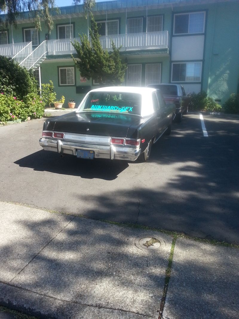

She also made up a 3 ft wide banner for her vinyl printing business "awkward GFX"
So if you ever need a custom vinyl decal, or lettering... pm me and she can handle it.

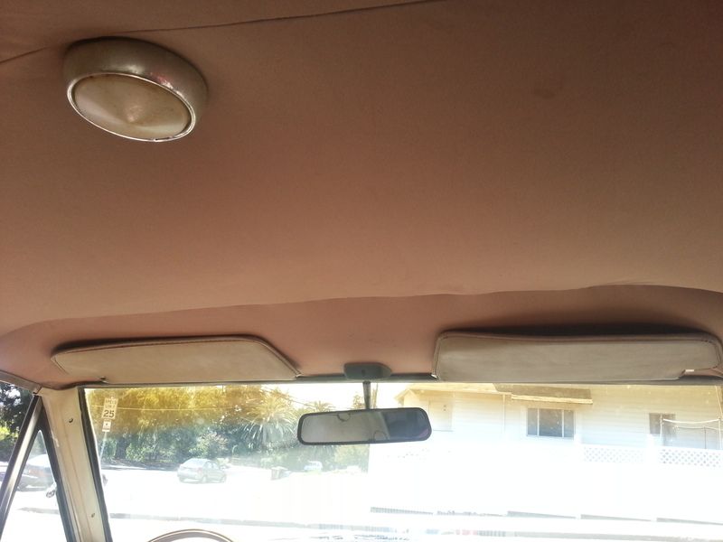

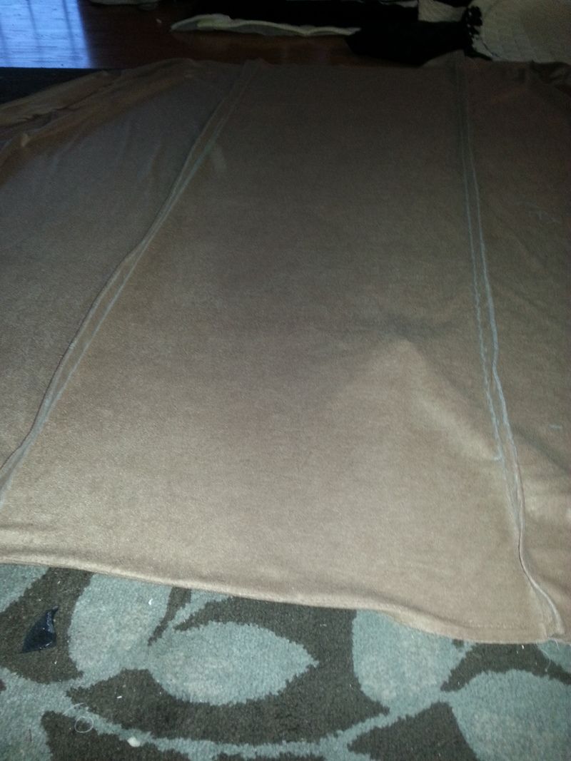

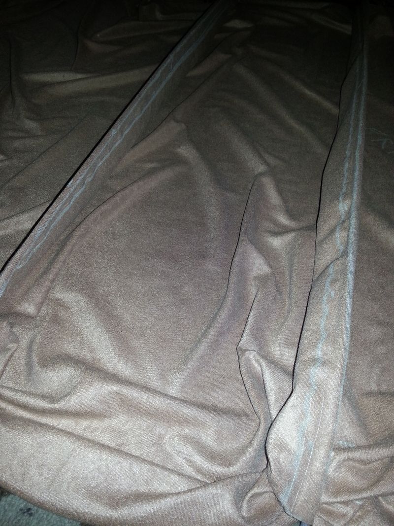

The other day we found a nice 2 yard bolt of suede brown fabric, that she picked out for headliner, with it flipped upside down, the back side of it is a perfectly neutral pattern for headliner, so we went with it, and it wound up only costing $15.00. I looked at a lot of pictures of headliners out of cars, and went for it on the sewing machine. Since we are missing some bows, and only have 2, I divided the car into thirds, found where they would go in their slots, and then sewed two seams into the 2 yard pattern and left even overhangs on all sides. It should leave a LOT of fabric at the front and back, and it leaves 10" on each side extra.
Measured the center of each seam and the bows, and cut the slits in the seam for the bows. I know on a traditional headliner another piece of fabric is sewn to the back to hold the bow, and multiple pieces of fabric are sewn together, I opted to just mark out the whole bolt, fold it, pin it, and double seam it. It's pretty sturdy. We'll cut the rear window and sail pattern when it's in the car since i don't have a pattern for it.
I'm hoping it will turn out ok. Better than no headliner at all.
Well, today I finally got the headliner I made into this car. It's not bad for a $15.00 investment. It's not perfect, but it's what I could do with only two bows and no headliner clips. I think it worked ok.

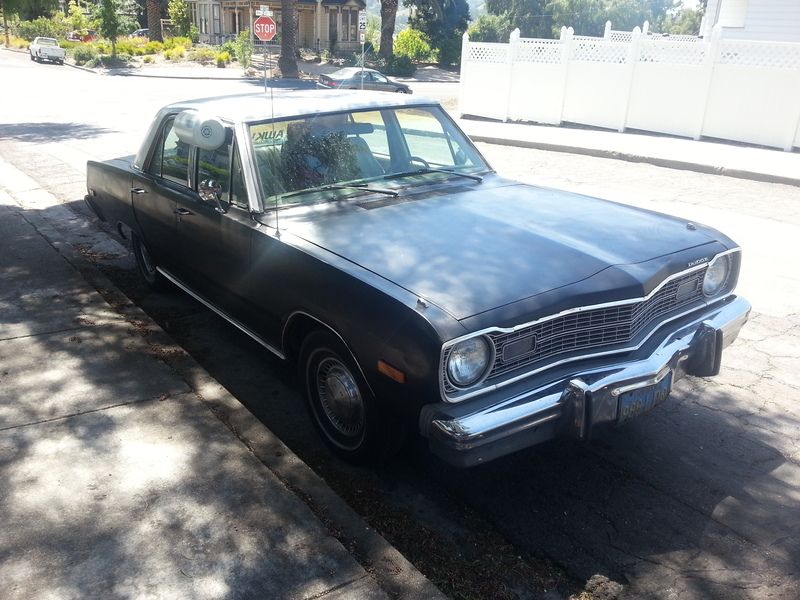

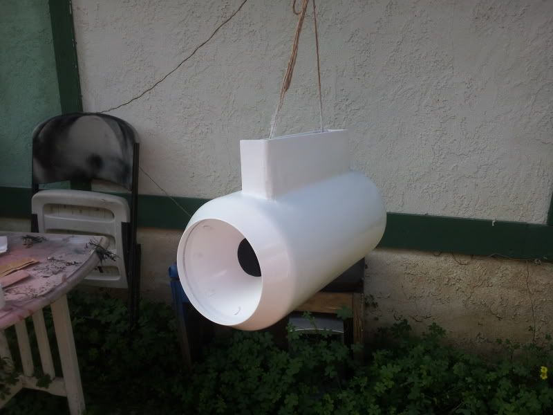

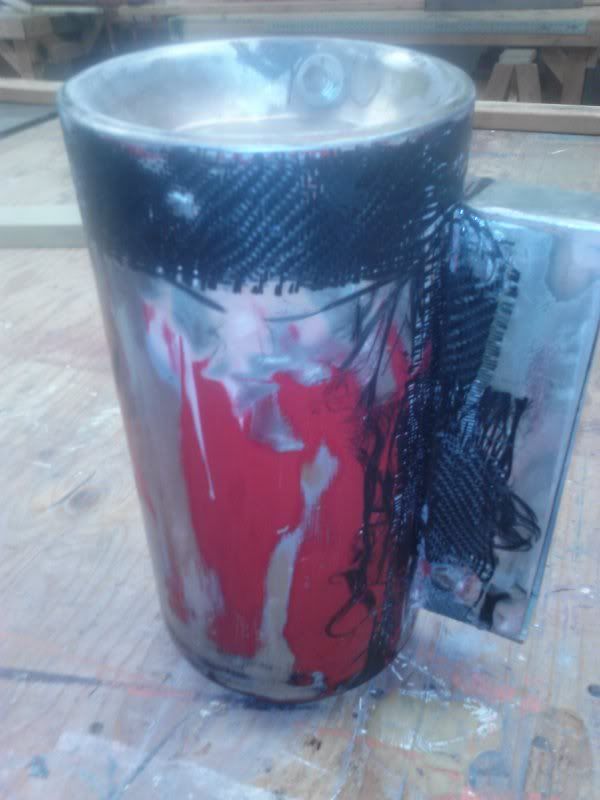

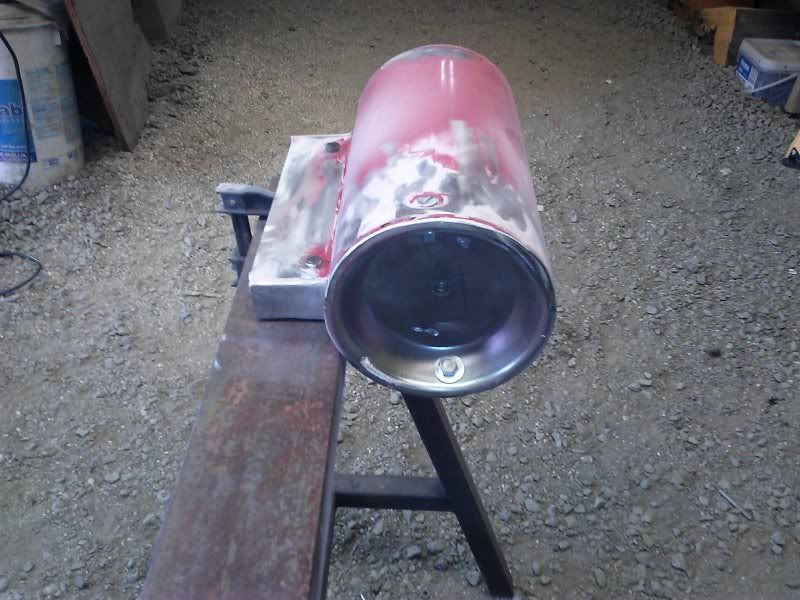

I also attached my homemade "swamp cooler" to the car since I made it about two years ago and have never really driven around with it. This was a just for fun project I did. It's made from a fire extinguisher and I made the bracket in such a way that there is no hardware or screws needed to attach it to the car. It just clips around the window frame. To remove, you open the door, lift up on the whole unit, and it's off.
It's made from half of a stainless steel fire extinguisher, some aluminum 1/4" stock for the outlet, some gutter insulation, an industrial food service heat lamp shade, an emergency eyewashing station dish and some carbon fiber. Basically stuff I found in the recyling bin at my old job, except the carbon fiber which was left over from an old project.

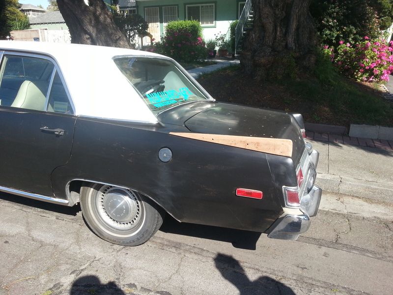

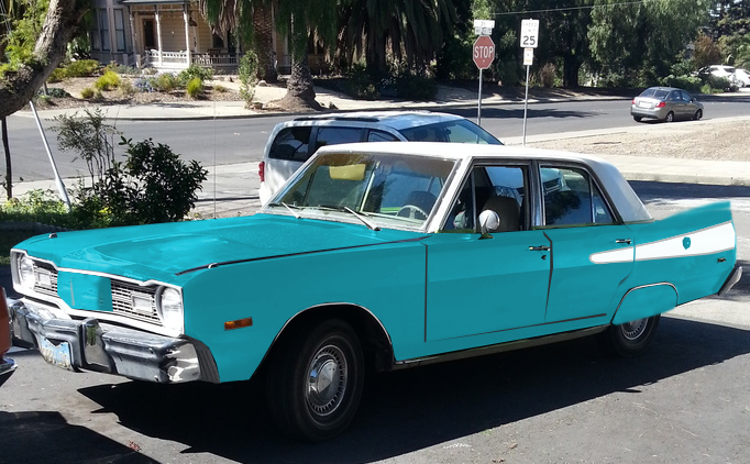

Well, after much discussion and planning, the fiancee' has finally decided on a color, and what she wants it to look like. I will basically have to make two custom parts for it, and I am ready to tackle the task - just to see if I can. To those of you who follow my other work, I don't play around with ideas of making things, I just make them. So here's what she wants, it may be a little weird to some, or maybe hated, but it certainly will be unique. I'm not 100% sure she'll want the white band on the back, but I think it would set off the vibe. Yes, she wants a 50's themed 1974 Dart. I'm all for it.
I think it's very imaginative. I already built a buck for the fins, but made them a little smaller than the drawing was, and they will need to be planed a little more to shape to the contours of the body before I can form metal over them, but they're a start. I'm going to sand down the paint off where the attachment point will be, tack them to the body, and then work it a little more. When I get them to a point where they work, I'm going to fill them with spray foam I think, then fold the ends closed to work with the same shape as the trunk extensions, then fill the gap between the trunk ends and the body. Then I'll get to work on the wheel well skirts, finish all the body work, then buy some paint.
The grill filler is just a thought, I'll have to work out a piece that doesn't actually block off the radiator, kind of like an earlier valiant.
It's going to be fun.
They're almost too subtle, being only 6" high at the rear most point. I'm wondering if this is more of a go-big or go home sort of thing, and make them longer and higher...
