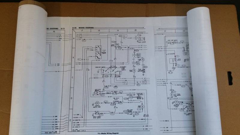

          When you get your FSM, print off the electrical schematic and tape it together like in these pictures. I find it is a lot easier to follow through that way!

          I did the same with my schematic, but I added cardboard backing with a couple of folds in it. Made it a bit more durable in the garage and I can lay it all out at once. And it gets used ALOT.
