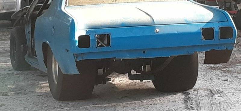

View attachment 1715517386[/QUOTE]
Alrighty now. But you should explain that these didn't just bolt on in place of Rallye wheels without moving frame rails, springs, and wheelhouses. And narrowing the rear axle housing. He did ask "stock" fit.
By the way, what size are those... wheels, offset, tires, axle width, etc. Looks just right!
I'm assuming you have a 8.25 rear end, 15x10 with 4.5 backspace will fit, like the silver car, but will rub some on the wheel lip. 15x8.5 with 4.5 backspace works the best without rubbing like the green car . Silver car has 295-50-15 BFG. Green car has 255-60-15 BFG. I'm not sure about 16 and 18 inch rims.
