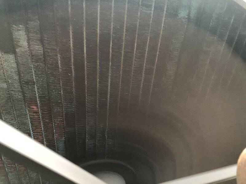

From the look of the thermostat housing, the radiator is certainly plugged. The water pump impeller may also be gummed up.

Yuck! That t-stat housing says a lot!
Imagine that through the whole cooling system including the passages in the block and head. Without getting too much into it, I'd drain and flush then drive for a few days with some radiator flush.
Then, your rad is definitely restricted and needs to be rebuilt or replaced.

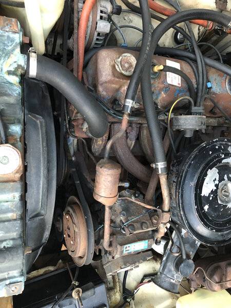

I idled the car and topped off the radiator once the t-stat opened. All looked well and I went for a drive, which turned into a one hour drive! I’m very happy. The needle sat just below the middle mark the entire time. (image 3). About an hour after driving I pulled over and let the engine idle 10 minutes to see if the temp would rise it didn’t move from just below middle. Drove back home and all well!! No leaks or overheating at all.

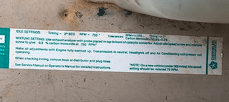

However, once I shut down the engine l and let the car sit, since the is no airflow, the temp gauge went quite high in my opinion (Image 4). Please see picture below. When I start up it will drop right back down to just below middle.

Yes its normal for the temperature to rise after shutdown.
Or don't believe. Go get a '76 owners manual and see what it says.
This from page 10 of the 1975 Plymouth Valiant Owners Manual.
PS. Look carefully if using Prestone. Last I checked they are not selling an IAT but a HOAT.

Read up some positive reviews on Champion radiators and their American Eagle line. Considering this brand. Only problem is can’t figure out how I know what radiator is in my 1976 dart. 19” or 22” is what the manual says. Does anyone know? I only see Champion providing a 26”. I’ll have to call them. Also, there looks to be a transmission line running into the radiator at the bottom. Is this what is referred to as a tanscooler?
