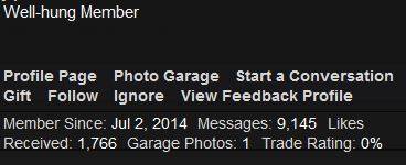

Random FABO tip - you can click on any member's user name & a menu comes up, including an 'IGNORE" feature. ;-)
Click it to activate.
