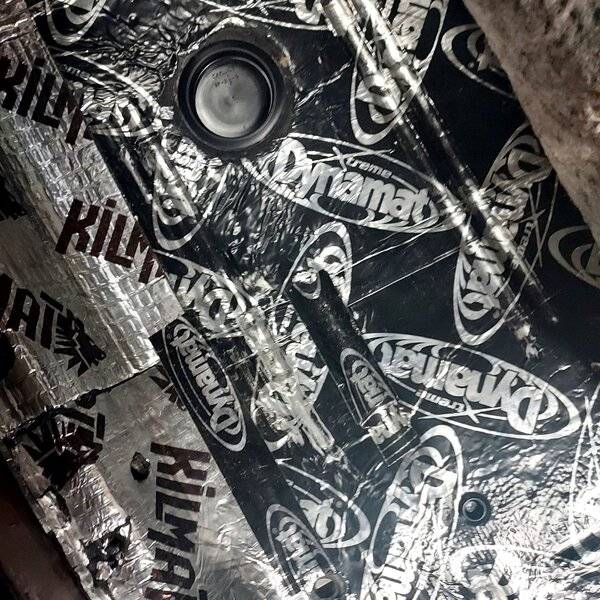

I'm still in the reassembly phase so I will add sound deadening inside the door where I can reach. I also need to redo some seals on the firewall, including the wipers (someone else's tip for when the dash is out). But getting the dash and windshield in and having it run again is getting close.

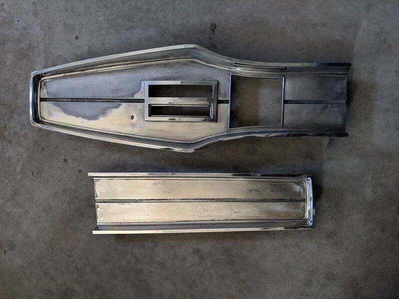

Great work! What did you use to clean your center console? What type of paint did you use when you put it back in?
Getting the last few things done around the firewall, before the dash and the windshield go back in. Thanks for the tip about the windshield wiper gaskets while the dash is out (who ever that was).

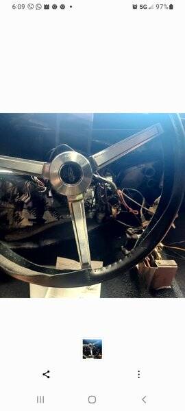

And had some help with the steering wheel.
On the chrome I used a brass brush. I used jb weld on the hole in the top and the sanded, taped and spray painted. I can find the paint can but it was nothing special.
For the main portion of the console I bought a black one off a guy on here. Epoxyed and sanded some cracks inside the console. Then I brushed off the sides (I wanted to keep the texture) and painted it with plastic spray paint and a clear coat. The hard part for the console was getting the cigarette lighter mounted right and working with the studs that had broken off the top.

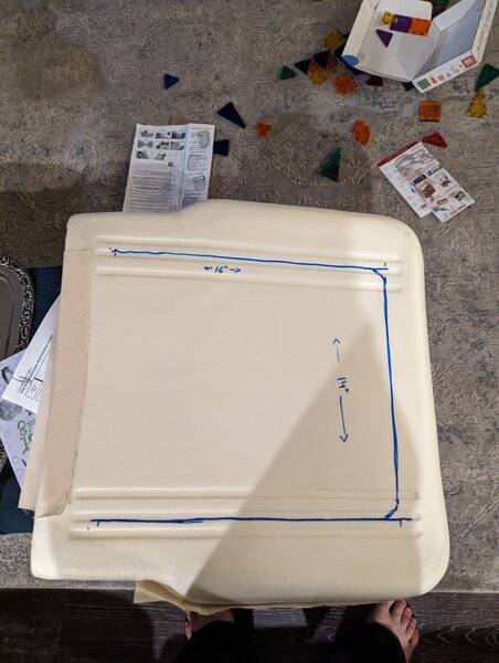

Finally have some time and all the upholstery from legendary. Got started but ran out of hog rings, as I way under estimated what I needed. More on order.
I tried 5 layers of cotton on the seat back, we will see if I over did it.
Next week it will be time to stretch the covers and see.

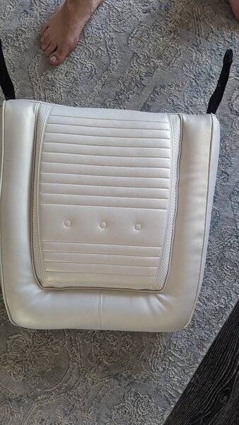

Progress made...
Driver's seat disassembly soon then a couple more afternoons and it should in in too.
Anyone looking to learn from my mistakes.
-5 layers of cotton on the rear bench top was too much.
-dont forget the metal backing for the bench top and hog ring the vinyl to the frame then realized you have to undo that and pull the vinyl to the tabs on the metal backing.
- try to compair rear bench top and bottom and get the seems to line up, I'm not sure how and clearly I didn't get it, front seat seemed easier to line up.
-us a trash bag between the foam and the cover for the front buckets seats.
-take your time, measure more times than you cut and good luck.
Unfortunately the ledgedary videos leave somethings out for this car but it can be mostly pieces together from what is available.

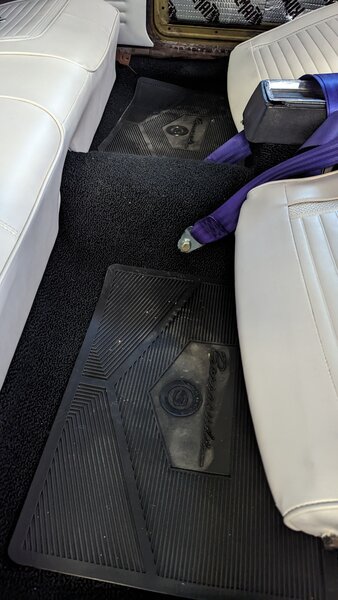

Last of the upholstery done. Added floor mats to try to keep the new carpet clean. And now working on the stereo and starting to pull at the electrical project string...
Those white seats look great, I love a white interior.
My Duster is white, I never did understand why people do theirs in black, too hot in the summer.
