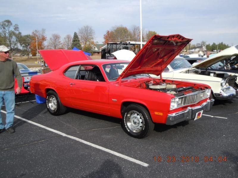

I just got my new wheels and tires for my 73 Dart Sport. I went with 15 X 8 in the rear and 15 X 7 in the front. I stayed with my P265/50R15 BFG Radial TA in the rear, though they are discontinued. I am going to buy a set of P295/50R15 because they will fit and my suspension is stiff. They probably wouldn't rub anyway, but I can't bounce the rear fender anywhere near the tire. I went with P205/65R15 BFG Radial TA in the front. It fills well. I don't have pics of the front yet because one rim is coming late today. I will get some and post them to let you see how they fit.

I sometimes work for a friend who owns a busy shop. I used to work there full time and opened it for him. I found them at ATD, or American Tire Distributors here in Minnesota. I just went online and checked their stock and also US Auto Force, and they are both out of stock. The tires are discontinued, so I doubt they will be getting more. I would have gone with P215/65R15 front and P295/50R15 rear in Cooper Cobra GT is I didn't find the matching BFG's for the front. I will hopefully get this thing done tomorrow and will get some pics. Maybe even a video of the tires roasting on the blacktop!
