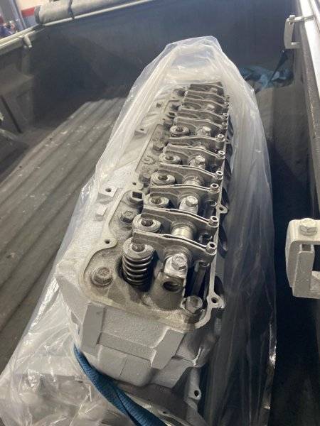

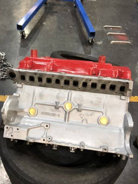

Got the motor back from the machinist I tried to talk to him about what I wanted but he ignored me as I probably would if some kid was trying to tell me how to do my job. Cant blame him. Old Mexican guy didn’t speak a lot of English and I don’t speak Spanish but I let him do his thing on it and it looks damn good. No porting but new springs and valves and “new cam” which I tryed to ask him what cam it was he just said new. But I’m not complaining waiting on offy 4 barrel and eddy 500. Not sure what to do about headers yet.
Looks good, sounds like he just put in a new stock camshaft? With the stock compression and stock camshaft super six intake with a two barrel carb and stock manifold to a 2.25 would be nice set up, but it's your engine you can go with any combo you like. Just make sure to crank the motor over before starting with the coil unplugged so you get some oil flowing then break her in!
