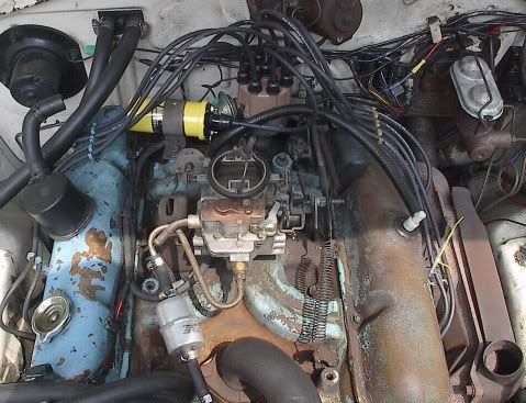

i haven't looked at the casting number, but does it look like this?
That's the intake for a 67-71 318

a single plane 2bbl intake isnt stock on any car. probally a mopar race piece. IF ITS FORM AN EARLY 273 IT WONT BOLT TO ANY OTHER HEADS.
that's definitely the stock 70 318 2-bbl intake...single plane and all. Check out the patina on the valve covers, heads, and block. That engine was never apart!
