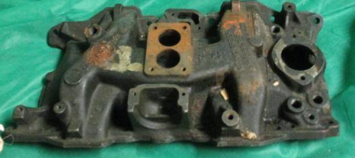

As in older intake, the picture below references what I'm talking about
If that is the single plane you've got, go with the dual plane.
Why, you ask?
Because of that stupid bathtub choke well that constantly eats gaskets leaving you with another frustrating exhaust leak right next to the carburetor.
You won't notice a lick's bit of difference performance-wise, but by the time you replace your third gasket you'll be wishing you had used the dual plane with a sealed choke well.
Why, you ask?
