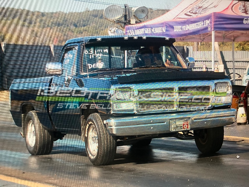

My D150 , 5.2 Magnum , shorty headers , 3 inch single exhaust , hi perf computer , 518 with shift kit and reworked lock up converter , 4.10 sure grip , traction bars , B Body Rancho Shocks , 275/60 R15 drag radials goes 2.00s in 60 ft has ran 14.98 best average 15.20 -30s at 85 mph ...4.10s made a big difference over the 3.55s it had
