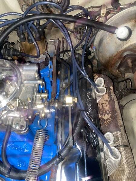

Yes sir, made sure the kick down was 100% functional, not interested in replacing the tranny. Lol. Excuse the pic quality my lens is buggered. Had fabricated one up at work and it work’s perfectly.

Just be sure that whatever you do, you can get actual WOT (wide open throttle) when the pedal is to the metal. I have seen (and read on this forum) dozens of instances where people are not getting the performance they expected after a carb swap. Lots of times it turns out that with the pedal all the way down, the linkage on the carb need to move another 1/2 inch to be at WOT. That can always be adjusted out.
Well this thread should be a sticky. You actually LISTENED to advice and FOLLOWED it. A lot more than a lot of these yahoos on here do. They ask advice and then do the EXACT OPPOSITE of what they are advised to do. Nice work.
