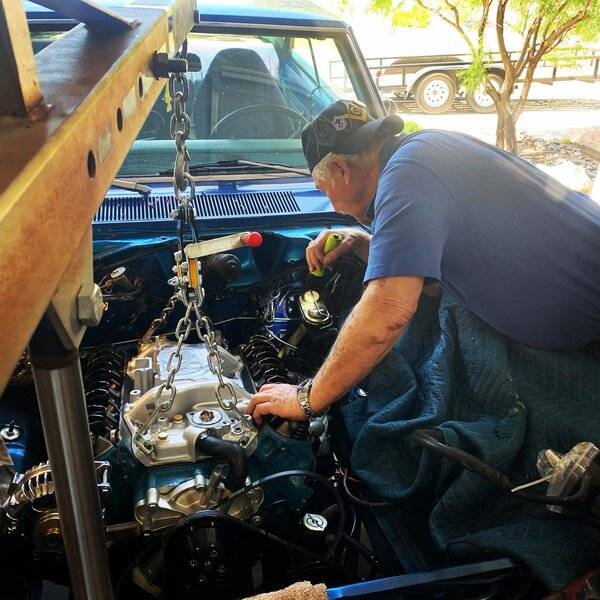

Here is my pops helping out.

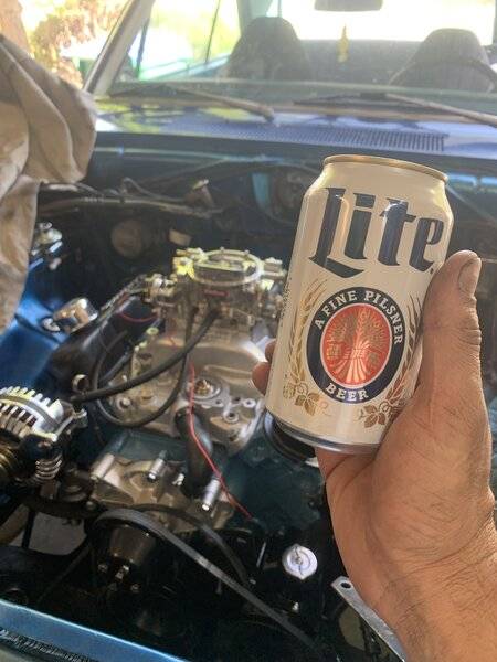

Cheers! Not the tastiest beer out there, but it sure is refreshing on a hot day!

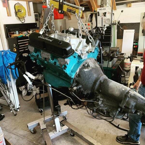

Unfortunately, I screwed up and installed the torque converter dust cover BEFORE the engine, so I need to pull it out. My dad didn't catch this, so we decided that since the engine has to come out a little anyway, that we would pull the tranny also to make it easier to mate the engine and tranny. Boy, next time I pull an engine I'll be taking the transmission with it. It's next to impossible to get those bellhousing bolts in while the engine is in the car. (And my pops gave a firm "I told you so.")
Haha!! The majority of this build I've done on my own, because I wanted to. But now that he's helping drop it in, I realize I did a lot of it the hard way. BUT....I think that'll just make it easier for next time. And there WILL be a next time. This really is a lot of fun.

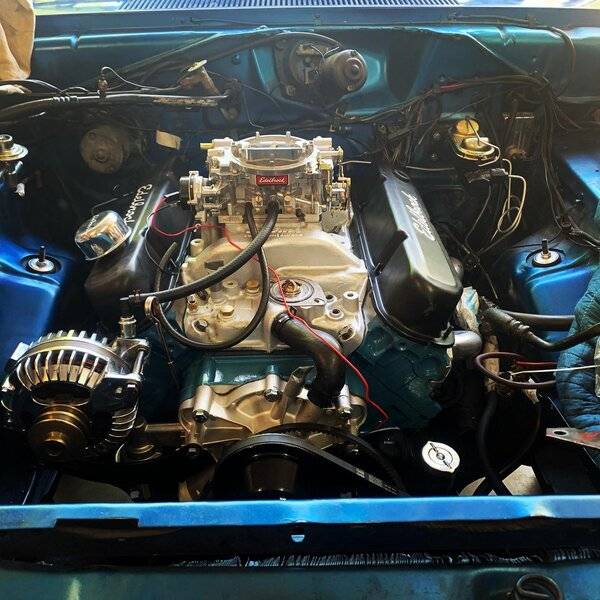

Engine's in! boy, I will NEVER pull an engine without the transmission again. It's so much easier pulling them/installing as a unit, but I'm sure most of you could've told me that. Now it's time to get everything connected and figure out where to install the ignition module.

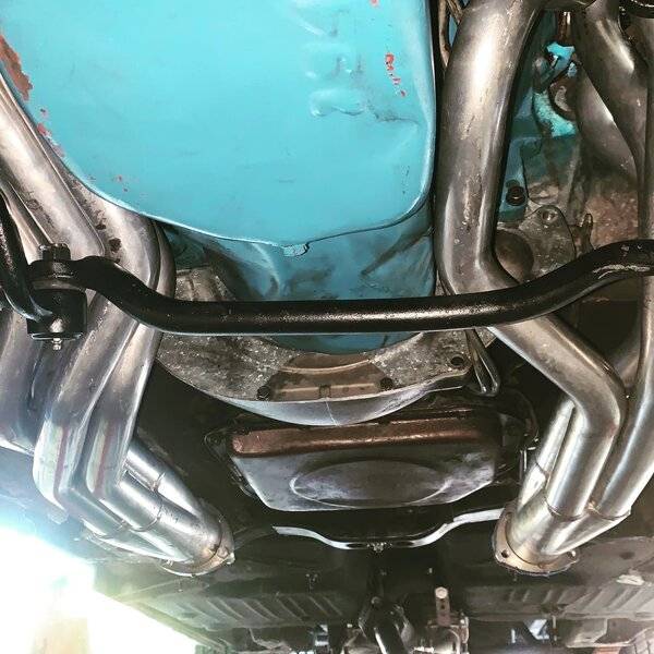

I made some spacers out of 5/16" plate to keep the headers off the tie rod ends. They seem to work, at least while the car isn't moving.
Nice. If u check out the mounts for a 72 up truck they are quite a bit thicker. U will want to raise ur trans up at the back so u don’t have a vibration. Kim
Thanks for the tip! Would you just make a spacer of the same thickness and put it between the crossmember and tail shaft?

So then u didn’t have the spacers in the mounts last summer? U will have to check and see how much room u have to raise the tranny. Kim
I didn’t have the spacers before. When I pulled the engine out, I noticed a spot where the headers had been rubbing on the tie rod end, and it was suggested I put in some spacers. So maybe worst case scenario I could just raise the tranny a little? I’ll have a look and see how much room is available.
