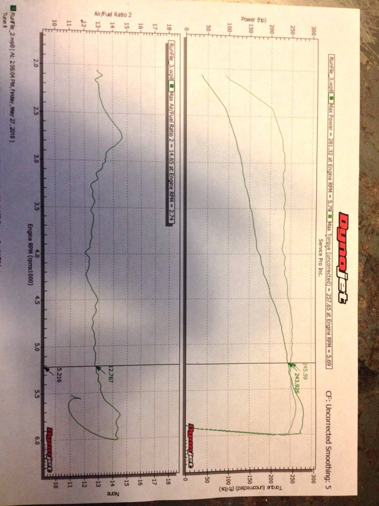

Thats a really good rear wheel number, it would beat my 340 by a lot.
it's pretty stout, here's the Dyno Sheet
Peak torque is really high in the curve for that cam...
Yah, it looks like 5600 is where it started getting lean cause (I think) the float bowls were running out of fuel. Otherwise it looks like the torque peak might have been at about 4800.
Seriously considering going FiTech EFI.
