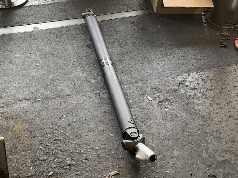

I changed my 904 to a 727 in my 1974 Duster, you will need to get your drive shaft modified to fit the 727, the 904 trans cross member will fit. I had a new drive shaft built.
