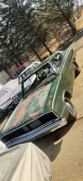

Any pictures of the car? I have a baby blue 66 Charger.
Here's the most recent crappy Pic. It's original paint, had a few dings and dents, a lot of chips, a little fading here and there. So it's perfect for a driver. Buffed it out and Did a lot of work to the interior. Painted the dash, cluster, and pad. New carpet. Those are dodge camper van seats I sprayed to match. Also put in a new headliner. New windshield, used rear window. Patched the passenger floor and trunk. Very clean Texas car. Pretty much built out of parts I had or got pretty cheap. It's been a pretty low expense build. Paid 3500.00 for the car initially last fall.
I bought a 66 charger this winter too. It was cheap and very clean. Just cooked interior that's completely disassembled. Has a pretty strong 440 in it. Not sure what I'm gonna do with it. Need to put in a windshield, fix brakes, etc etc to make it road worthy.
