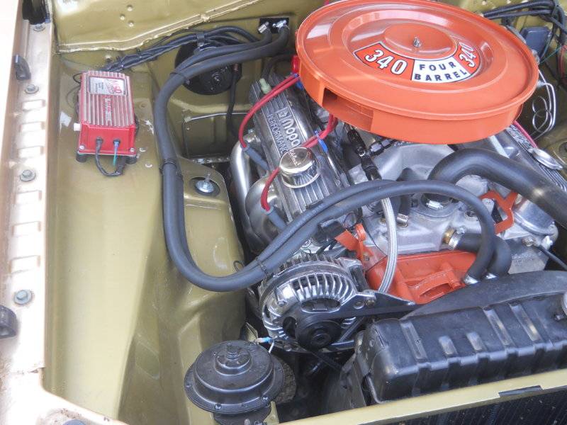

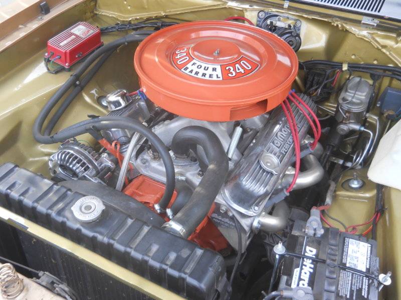

I had the same issue with my Duster. Like stated above the fuel boils. Even after my car sat for 1 hr it was hard starting and when it did start it was flooded with fuel. I would have to turn the pump off and on until it received fresh fuel. On my car I had to change the regulator to a return style and put it after the carb. Pictures below. The car did not do this with leaded race fuel. Only on pump gas going to shows. After I change it over it ran more consistent through temp changes. What I did is what you would do on a holley dual feed line with electric pump.
On a carter style this is what you want to do.
Most mopar V8's from mid 70's and up had a return on the filter for this reason. There was third nipple on the side that would flow back to the tank. The float in the carb will not function properly with hot fuel of today when the fuel is dead ended up against the needle and seat while hot. Adding a return eliminates this problem. They added the return to the filter and routed it back to the tank.
How to check if this is your problem is . After the car is hot and before you go to restart it. Take the fuel line off at the carb. Put a hose on it and run it into a container. Turn the car over until fresh cool fuel comes out. Put the line back on and it should start. I have done this 3 nipple filter on several cars that come here with this problem.
A cool can also works but then you need to carry Ice and use a shut off for the fuel before shutting the car down.
This new fuel is terrible in our carbureted cars. It is the float not working in the carb that causes this issue

My car never did it unless you left it sit for 1/2 hr to 1 hr. Then when I went to start it to leave it it would have the problem. If I would leave the pump off it would fire right up and I would have to turn the pump off and on until fresh fuel came through. If I would turn the pump on first it would flood the motor and just crank while I held the throttle 1/2 way until it fired. The float would not close the needle with the hot fuel. I tried three different carbs . Proform, BLP, and a quikfuel. All did the same thing. After I eliminated the fuel being dead ended at the carb problem solved.
I would always sit at shows with the hood open. 100gph pump and regulator on 1/2 inch fuel line from tank to carb. This problem drove me crazy for a long time. We just finished a aluminum head 340 Demon and another iron head Duster. They do not have this problem for some reason. Tap the key on them and like my Duster .
Click-Vroom, every time. LOL> Some cars do have this problem that we get them here off and on.
