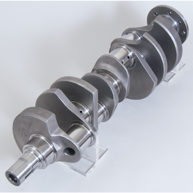

So I ended up buying a virgin 340 Forged crank for $200. Looking to build a .060 11/1 street car motor that can hold its own against some of the new stuff lol. Hopefully a 55 year old crank can hold up. lol
I'd have it magnafluxed and if it shows no cracks, it's already better than any of the new stuff.
I'm hearing a lot of that. Unless I'm looking to spend a lot more money , I think the factory forged will be fine for my application.
