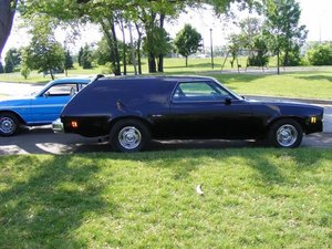

Yes do a search for member Waggin,he has done the 4 door to 2 door swap on his 4 door wagon.I also have a friend in Hamilton that has done this to a 76 Chevelle wagon 4 door and also shortened it.Here,s a pic..
Dam that thing looks like an EL COMENO with a roof not bad for a chevy.and it kills me to say that...Artie
