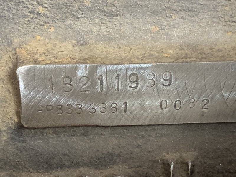

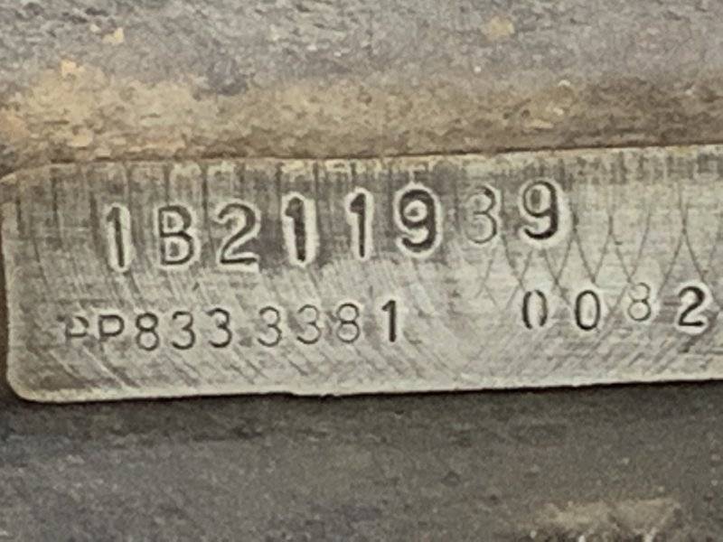

so I bought this 4 speed trans and I’m wondering what it came out of.
1971 model- built on 10/30/70.
82nd 4 speed built that day..
71 Hamtramck car. 1 B is 71 Hamtramck. The 211939 is the vin of the car it came from.

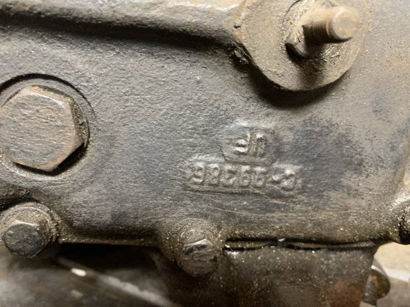

Without the part number we can't tell. a 7 digit number starting with 341 or 351 will tell us. A photo or two would surely help.
If it has not been apart before &;
it has a single shifter mounting pad, it came from an A-body.
-or-
If it has dual mount shifter pads it came from an E-body but would also work in a B-body.
