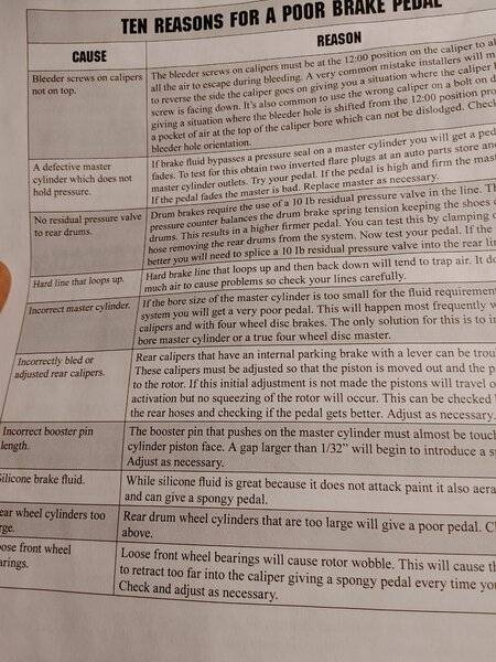

Came with my rear disc kit
I switched to a 1” M/C cause I didn’t like the soft pedal on my four disc brakes.
