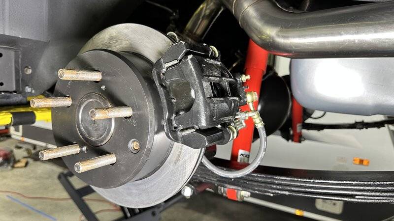

How many miles are on the rotors and pads at this point? Is the picture of the rotor you posted the current condition or just a picture from when you first installed them?

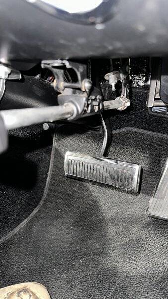

With it applied as hard as i dare there’s 3 ridges past the upper mount (see photo)- this is 10 clicks in total which may be one or two more clicks than I previously tested it at! I might test it again tomorrow to see if that helps.

Hmm, ok. When fully applied on my car I'm usually pulling 5 ridges clear of the upper mount.
60 miles should be more than enough for the pads to be bedded in, so that shouldn't be an issue. Is the picture of the rotor you posted earlier before the 60 miles?
Yes it would have been at about 45 and just before the track day tests. Having said that any meaningful brake bedding in work would have only been during the last 15 miles as the first 20 or so miles would have been spent on a chassis dyno!
Ok, because in that picture it looks like the rear brakes are barely doing anything, you can still see the original rotor texture and after bedding in that should be entirely gone where the pads ride.
