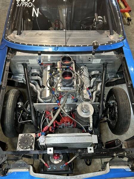

414” W8 first start in car

I see Ron's Toilets and a Dry Sump Tank... :D Where's the heart emoji when you need it?
first time using a dry sump. i have a heating element installed on the oil tank. i plug it in and the oil got to 30*C in 20 minutes. after the oil is warm, i spin the pump with a small ratchet to prime the engine. works really good.

yes yes yes. i have a single plane intake for this engine but can't use it knowing the tunnel ram is there!!!
