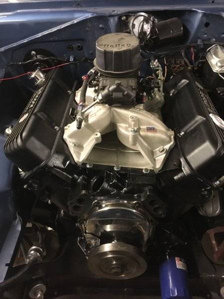

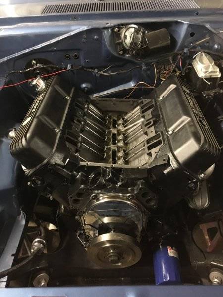

Got it apart today. All lifters turn in the bores like they are supposed to. Only that one lifter and lobe was gone. Everything else looked decent till I started pulling cam out. Cam seemed sticky sliding out at first, it pulled one of the cam bearings out of the block. I have never had this much trouble in my life with a engine.... Got a mess

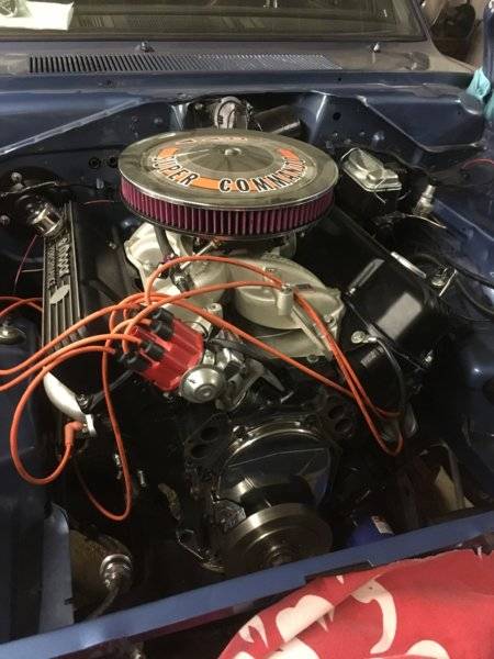

Got the car on the road yesterday, different block, she’s running great now! Thank you for all advice guys...
