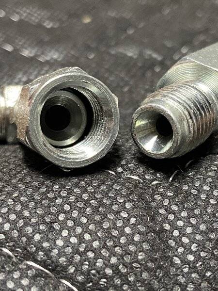

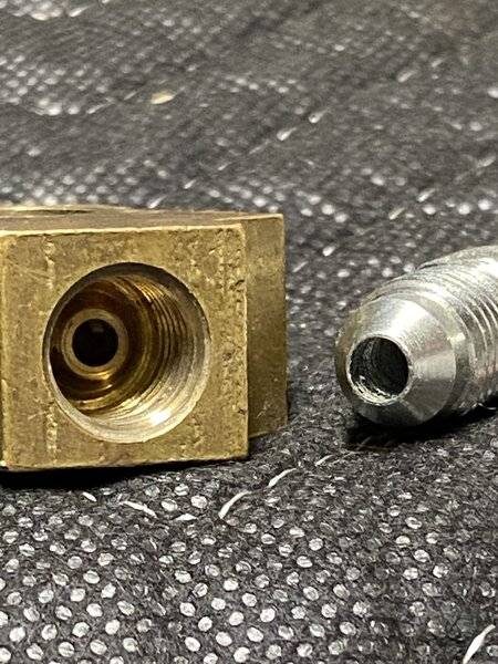

I purchased the 90° adapter recommended above, but besides being 90° when I really need 45, I think it’s got flares, when I think I need inverted flares? The 7/16 x 20 threads are correct, but I’ll end up with the wrong flares pointing at each other. Maybe the photos will help.

The 90° fitting screws onto the hose OK, other than to opposite flares pointing away from each other. But the fitting can’t screw into the block because of the two flares pointing towards each other, I can only get about a quarter of a turn of thread engagement before the flare “cones” bump into each other.
Brake lines are inverted flare. I don't remember the angle. The 90 you have is a JIC hydraulic fitting that is 37 degree. Brass flare fittings are 45 degree.
The above is correct. He is talking about the angle of the flare itself, not the angle of the fitting. I've never seen such a fitting as the OP wants, but some of the aftermarket/ specialty tube/ fittings/ hose guys might have them.
