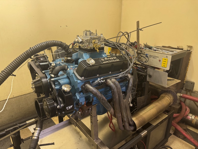

Hi everyone.
Haven’t posted in an awhile but still read here on a regular basis. I built an engine over the last while after reading a lot of information on this site even through I am a truck guy. This forum is definitely the best for small block information.
Anyway finally got time to test the engine this weekend. Test went well at the start, and ended poorly but it could have been much worse.
Build is a 94 magnum block, stock bottom end all freshened up with a hone, new rings and bearings, deck cut 0.008 just to square it up. With the 0.028 head gaskets it worked out to around 9.3 static compression.
I have the OG NZ EQ heads with 2.02 valves, bowl blended and port matched to an Eddy LA air gap intake and a Holley VS 750 carb.
Cam is a Hughes SER1822ALN-10 with their premium roller rockers (purchased before the price went up) just to make me feel better about the fast ramps the cam has. Cam is installed at 105 ICL.
Goal was a nice street cruiser that had lots of pull for a 78 Warlock that will have 3.91SG and a A500 OD transmission with 28.5” tall tires and 2500 SMR stall.
We made 3 or 4 dyno pulls and the results started repeating so the rings were seated. We then took the RPM range up and things were going great. For the test we had a 1 inch open spacer during the pulls. We wanted to see what taking the timing from 34 all in to 36 did, but when the engine was at idle something sounded off all of a sudden so the dyno operator shut it down right away.

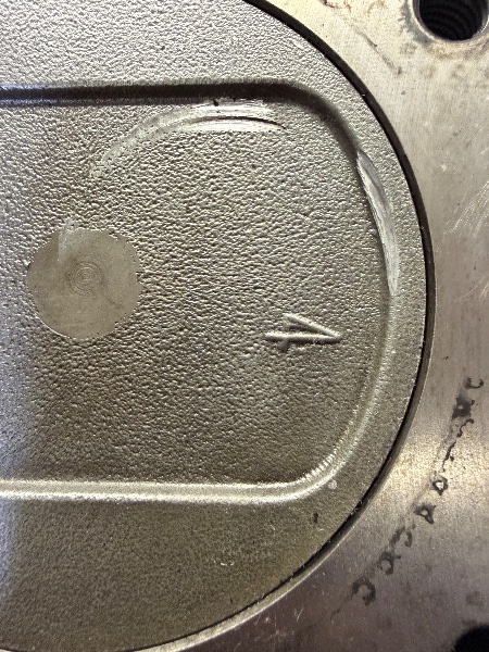

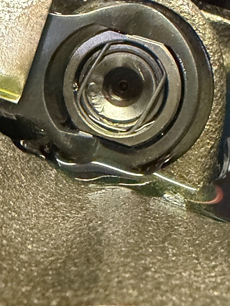

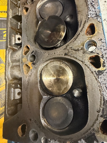

Long story short I had an intake valve stuck and bent a push rod. Piston has a little mark but hopefully I got lucky. The EQ heads did not have bronze guides, but the heads had been reamed by the person who did the valve job. Needless to say the heads will get guides as part of the repair.

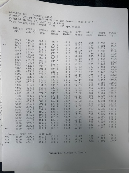

See below for the one of the runs we did. No jetting or adjustments had been done at this point and we felt it had more left. I know these types of builds are posted a lot on here, so I wanted to share some numbers anyway.
Hope these help others.
Nice flat numbers. Pretty mild on the cam. Smaller than the Mopar 380 crate motor, but you out did it.

Hopefully my repair is minor. Going pull the heads tomorrow to take to the shop.
Yeh, EQ heads without guides are a pretty risky proposition.
I refreshed a set of used ones several years ago.
No stuck valves, but someone had reamed the guides so they had excessive clearance.
I put bronze liners in them.
Looking at the fuel flow disparity between A & B, it would appear a weaker secondary spring might yield a few extra ponies.
The secondaries don’t look to be open enough to contribute anything till after 4k.

Yes, I will definitely be heading back to the dyno after the repair. We were just getting to the fun part lol. Glad the valve hung up at idle or things likely could be going a totally different direction.
Getting more timing and the secondaries sorted out was what we were about to get into. All my pulls were only at 34 degrees. Hopefully have some more refined results next time!

It can't be "just" the stainless steel unless those particular valves are some kind of weird alloy. Plenty of factory and aftermarket cast iron heads were upgraded to stainless valves over the years and were not really prone to sticking the valves. At least not that I remember. So if clearance was adequate, either the alloy of these particular valves or the alloy of these particular heads is causing the issue. Yours caught my attention because the guides were supposed to have been sized by the shop.
Now I have no choice but to go back and install bronze liners in mine too before I run them. Been worried about that for some time and its the reason I have not used my heads yet. Same as yours; New Zealand castings.
I thought Hughes had stopped selling them assembled without the bronze guides.
PIE also installs them as standard practice.
PRH, I am pretty sure you are correct. They even had an article on one with stuck valves and that it needed to be fixed with bronze liners, but then at the end of the article they say something like "oh, and it had an intake air temp sensor reading wrong so we replaced that too." Fuel injected truck.
Mine were bought bare and were new from Jeg's before they were discontinued. I had them finished off locally with parts I supplied, but wishing I had also added the bronze liners at that time. My fault.

Pretty sure its the alloy of the heads that absolutely demand bronze liners. I just went through this with some EQ Chev variants. Looks Like your testing @ Daryls place. Seems like a good operator. Good luck. J.Rob

Pretty sure it’s the alloy of the heads that absolutely demand bronze liners. I just went through this with some EQ Chev variants. Looks Like your testing @ Daryls place. Seems like a good operator. Good luck. J.Rob
I will be dropping the heads off at the machine shop in London tomorrow for repair and guides. Will I need another valve job because of the guide work?

Piston got dinged and some minor damage to the lifter and rocker arm. Push rod was toast too. Hoping to reuse the piston and rocker arm. Will need a new lifter and push rod, maybe the dog bone too.
New guides = recut seats
Thanks I wondered about that. The valve job was nice on these heads but the shop I am going to send the heads too is well respected. I am sure the can do a nice performance valve job.

Picture of the guilty party. Valve is pretty bent so I have not removed it.
