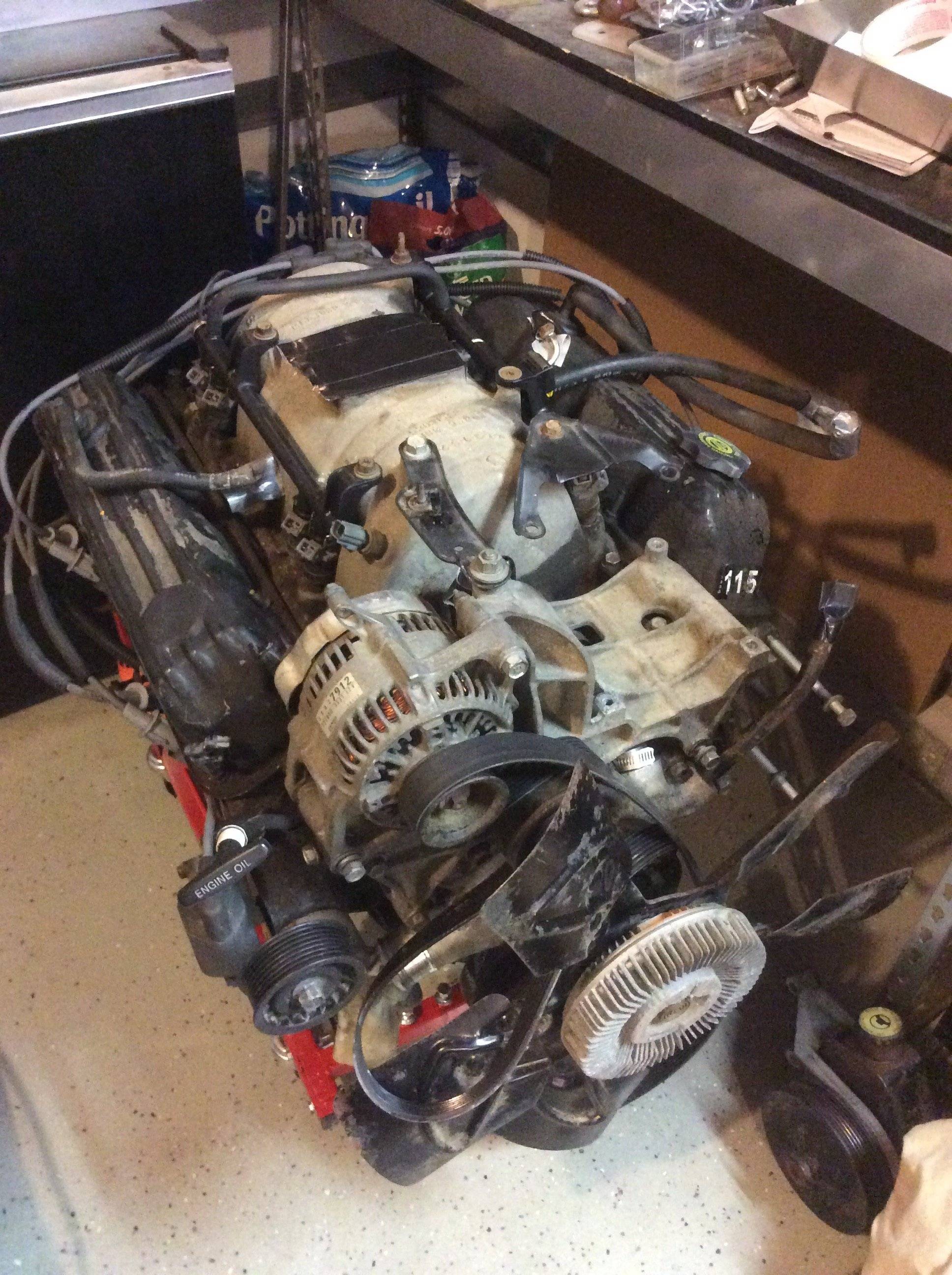

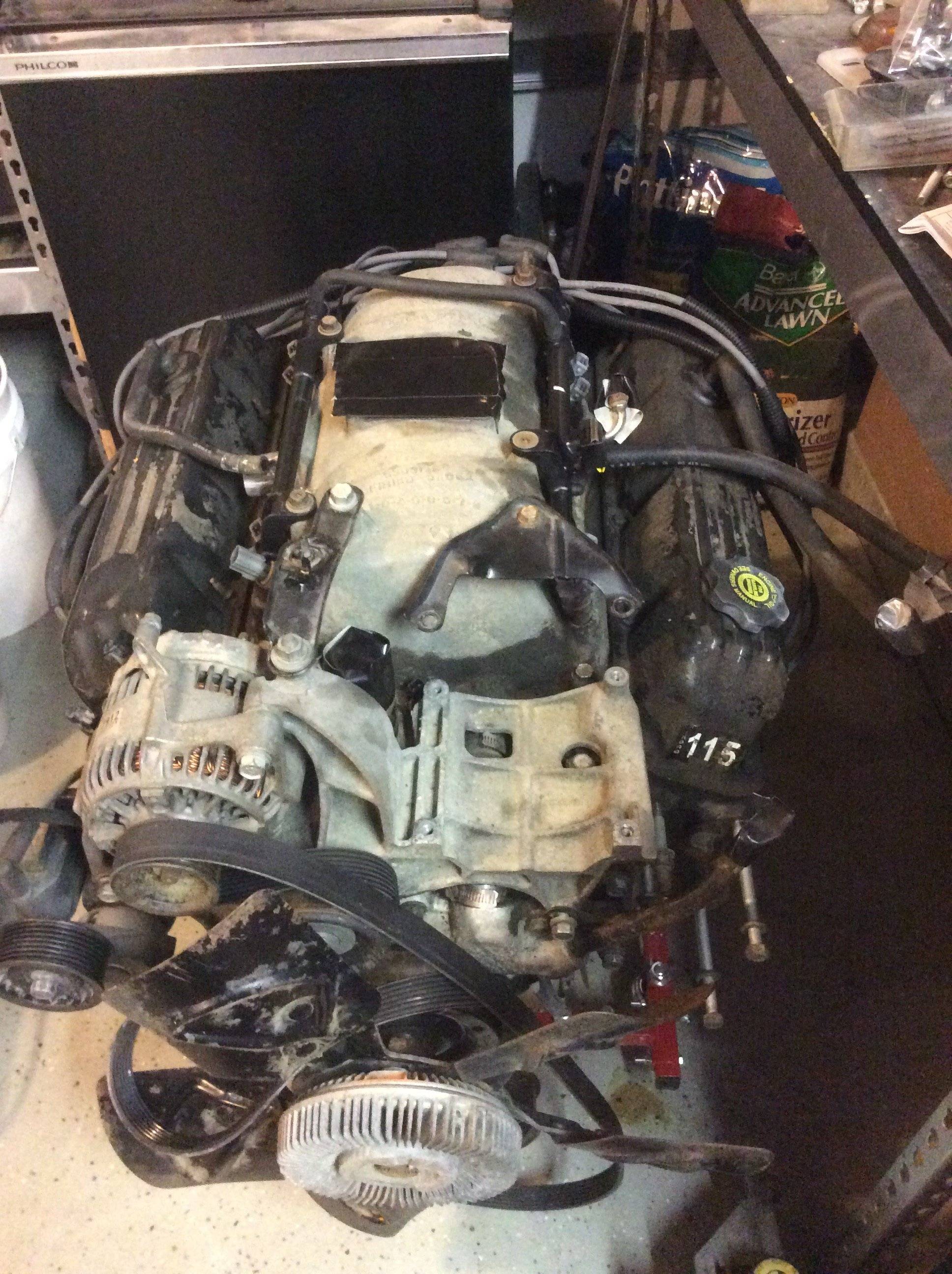

As stated before this is for sure a magnum and the seller either posted it wrong on craigslist or gave me the wrong motor I'll post pictures later the seller did have unknown year ramcharger in the garage stating he changed the chasse out on it so it's very possible he was either confused or sold me the wrong motor there was junk stacked everywhere took us 45 minutes to move junk just to get to the motor
thanks to the help of magnummopar I figure it's a 2000 + year due to the injector connectors

Serp belt shoulda been a tip-off to us, lol. '92/'93 W250s had Magnums- 5.2 in '2, both in '3.
Were the injector plugs really that different over the years? They all look the same to me. The CPS, IAT, Temp Sensor, CkPS, Coil plugs are very different.
Those are earlier injectors/connecters, and it has an EGR valve, which tells me its an earlier motor. I'm gonna guess it's like a pre-'96 motor. Just look for the block casting date on the side of the block.
Oh, and I just noticed the truck mount in the second pic. It's using the LA style mount, which tells me it was out of a '93 Ram. '93 was the first year for the 5.9 and the last year for the older body style Ram, that would've used the older LA style mounting ears on the block. '94 and later Rams used the 3 mounting pads in the middle of the block.
If this is indeed a 5.9, check the casting numbers on the side, or clean the area of the block right below the driver's side head.
I Haven't a clue on these but learning you guys are pretty sharp just took a quick look it's a 360 and a magnum bore is 4.0 and has 360 at the end of the casting number couldn't make out much more I'll have to get more involved tonight
now that I can see it, those are early injectors not late and dragbaron mentioned, its got an egr making seller correct, its a 93-95 OBD I 5.9 magnum. The late model post 99 injectors have round corners and harness connectors have small red saftey tabs on them.

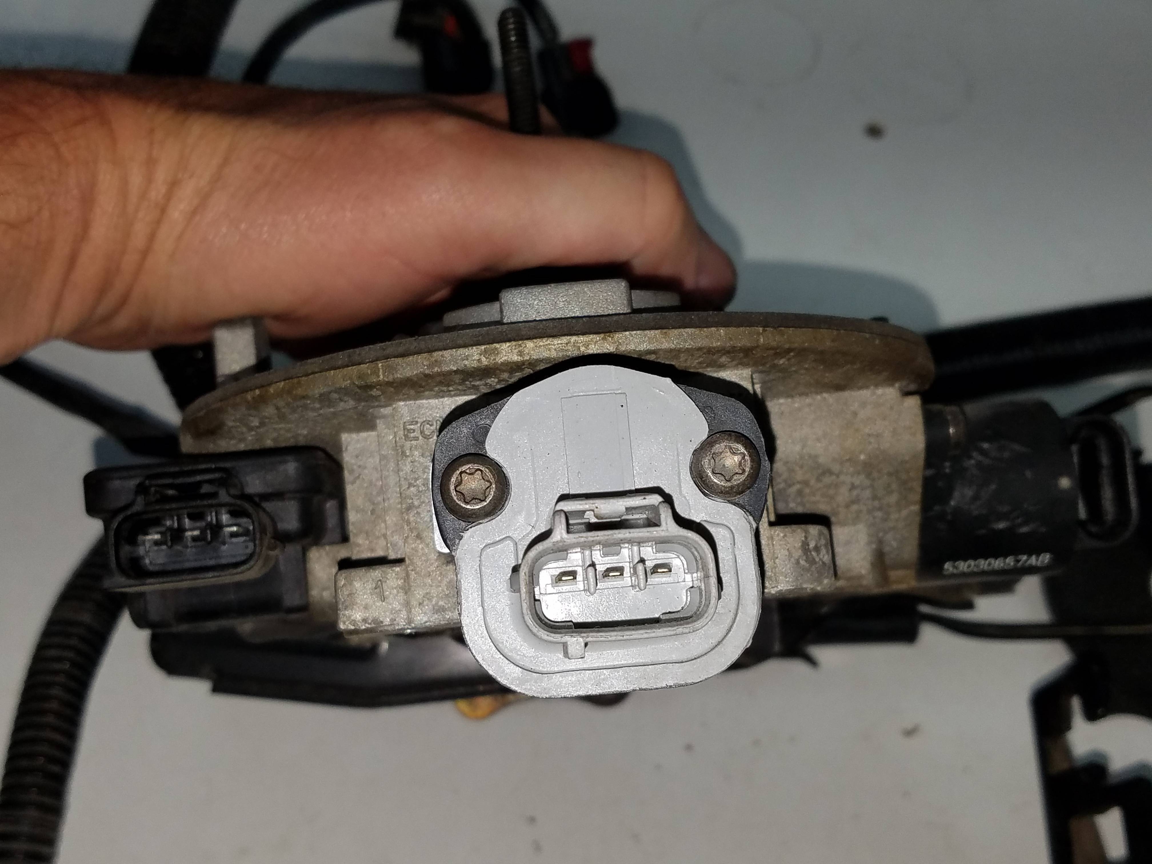

From what I can see its no newer than 98, but would need to see connectors on throttle body and coil, if it has big coil plug its 98 and down and if it has large TPS & MAP plug on TB then it would be a 96-97. It has a very odd fuel cross over line which made me lean towards 96-97 but Chrysler often carried some extra parts to next year. I took some photos so you can figure it out exactly.
Coil on top is 92-98, coil on bottom is 99-03.
This is early TB 96-97 Ram, notice large round pins on MAP and TPS
This is later 98-03 all models, notice smaller plugs with flat pins.
Chrysler did away with round pins when they went from 8V sensor power to 5V sensor power as less surface area was needed for lower volts. They went from 8V to 5V when they started using CCD Buss communications therefore, Rams in 96-97 had round pins but 96+ Grand Cherokee had CCD and flat pins and 97 Dakota has flat but 96 is round....go figure why Chrysler went broke? If it seems confusing, dont worry, its taken me 18 years and I still see new stuff all the time. We have lotts of info on whats what on our sites in FAQ section in case you get lost in the BS....almost forgot, 96-97 Rams have 2 coolant senders(1wire for dash and 2 wire for PCM) and a 2 wire oil pressure sender. :realcrazy:. Let me know if you figure it out or post a pic of intake by upper rad hose to see if it has 2 coolant sensors.
