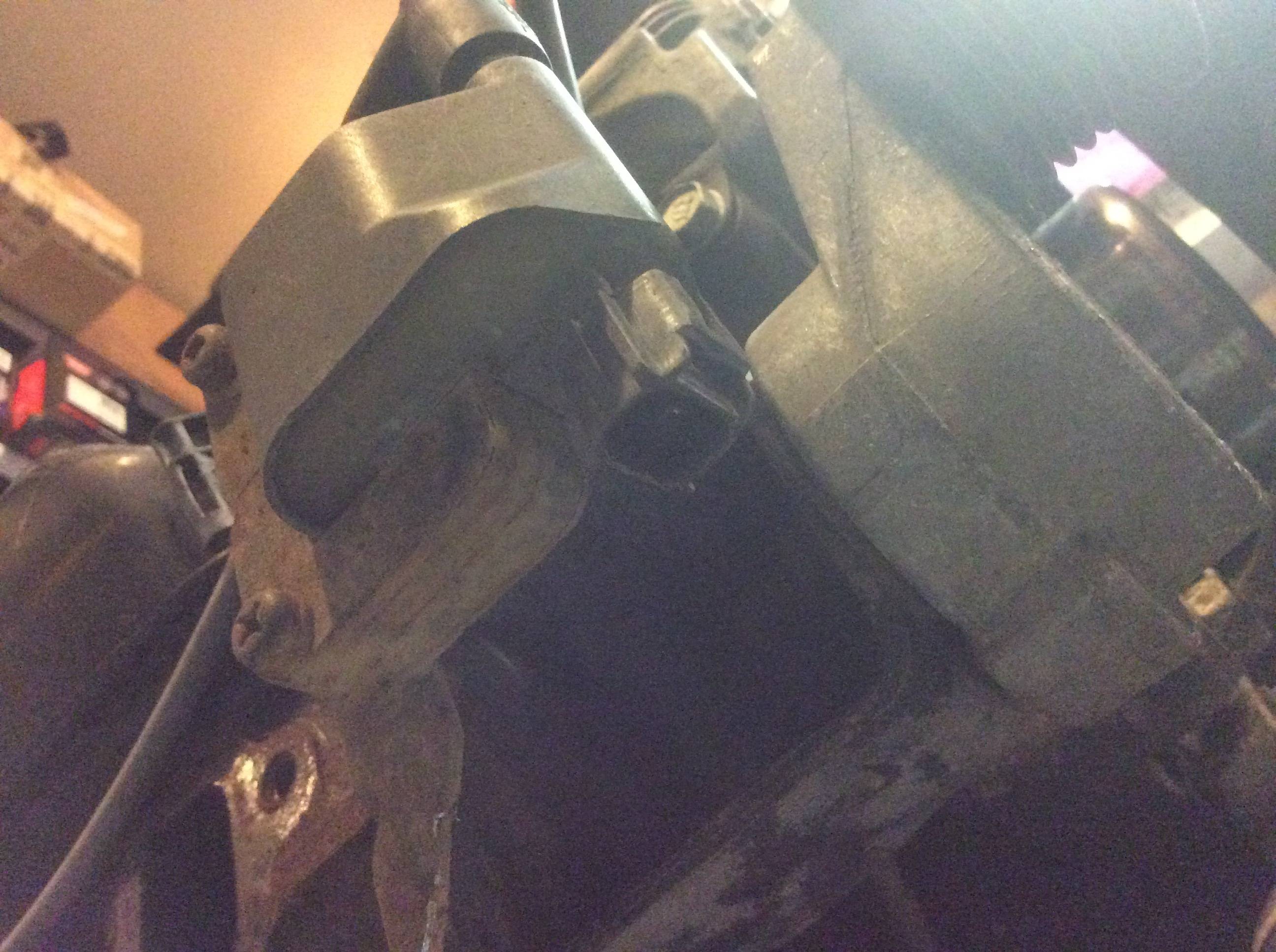

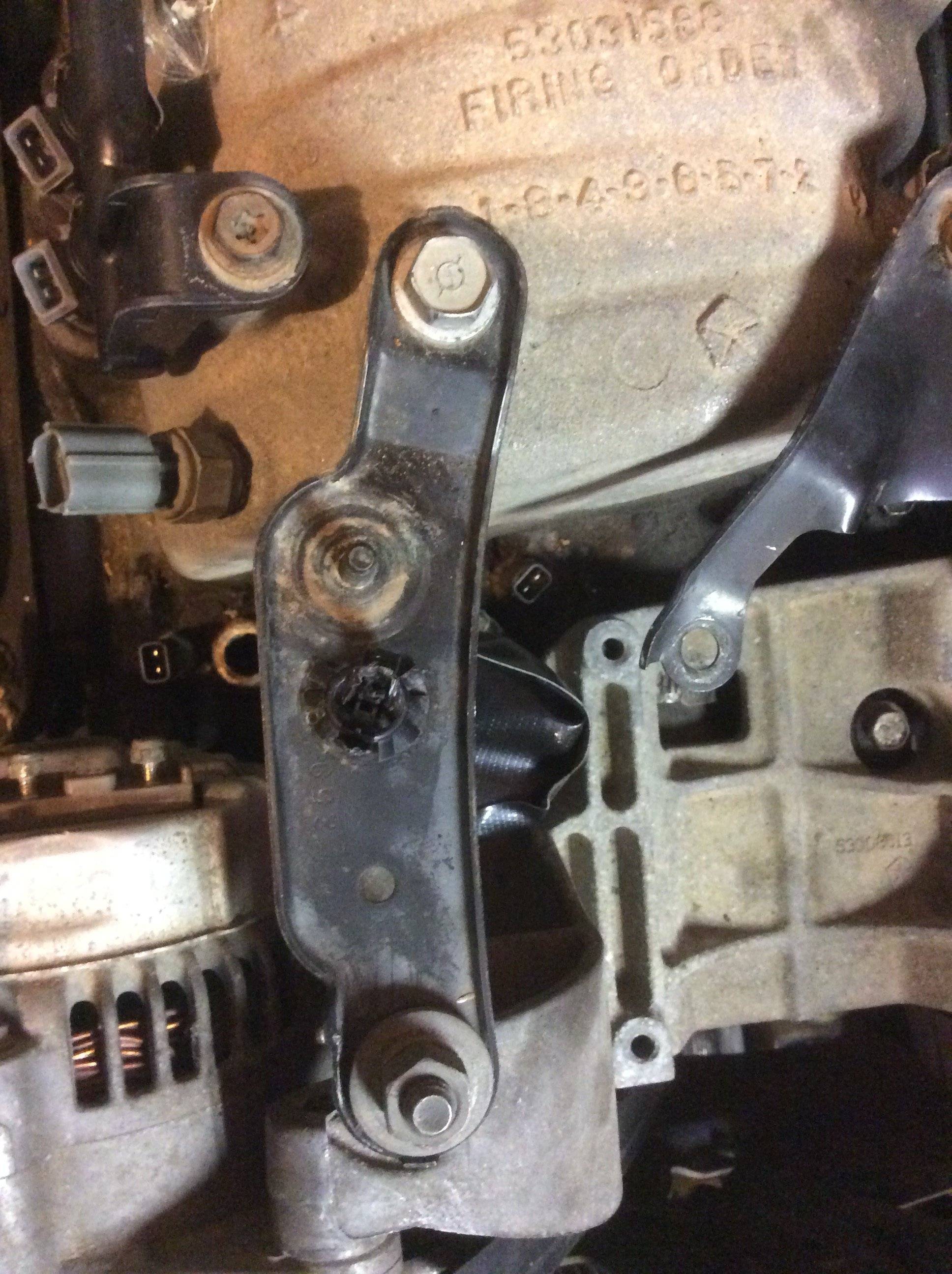

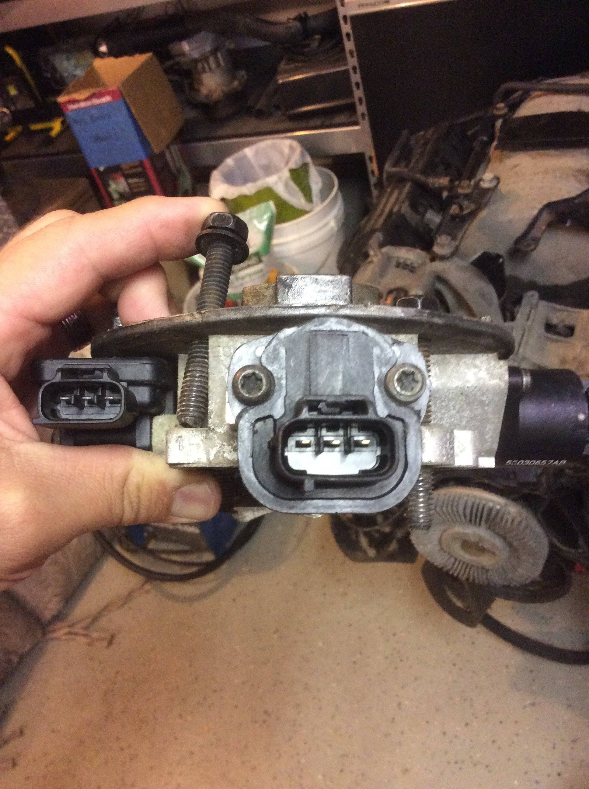

Magnum Mopar, thanks for the replies. Now that I know what to look for I feel more confident that it could be a '98 or newer. This is the throttle body and the coil with flat blade connectors. And yes 2 coolant sensors.
