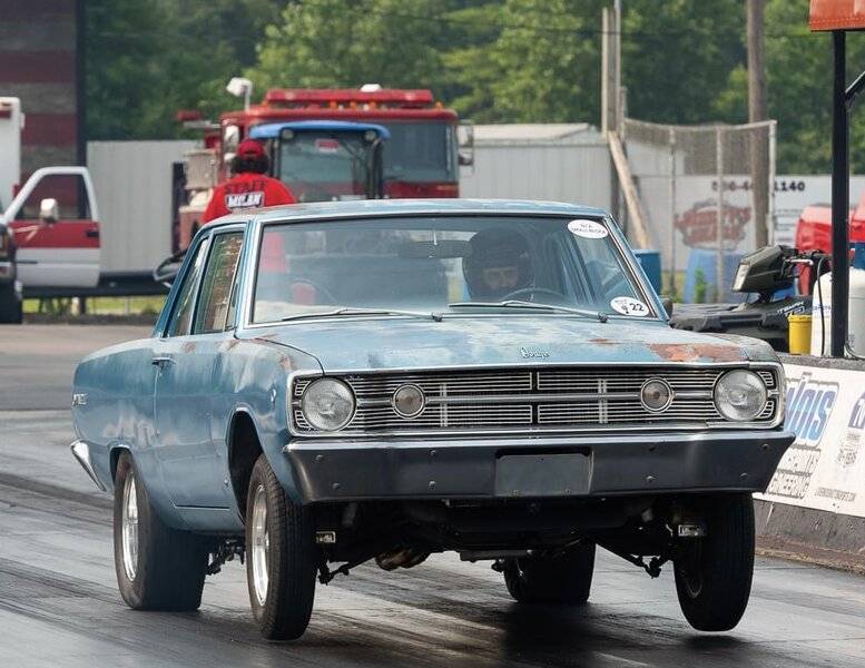

I don’t have you tube account unfortunately but it went 11.51 letting out at about 1,000 ft. Cut off was 11.50 no cage. Got it pretty spot on haha. Good photo of that pass
