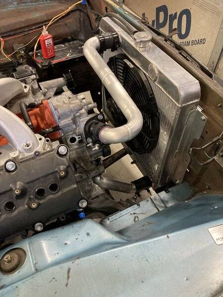

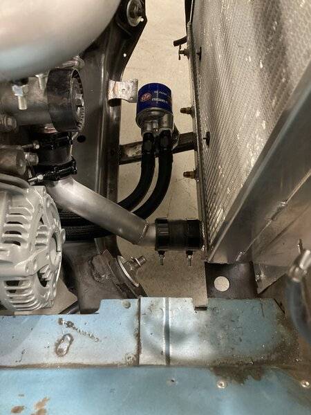

With those solid tubes going to radiator, will there be enough flex to keep from breaking the radiator?
Yea. Those are rubber couplers on there with room in between the rad and the tube
I see that, but they're not very long. I know it all depends on engine movement. And how soft the couplers are. Just hope it has enough flex.

It should be flexible enough. There will be a front to back limiter and a torque limiter on the engine

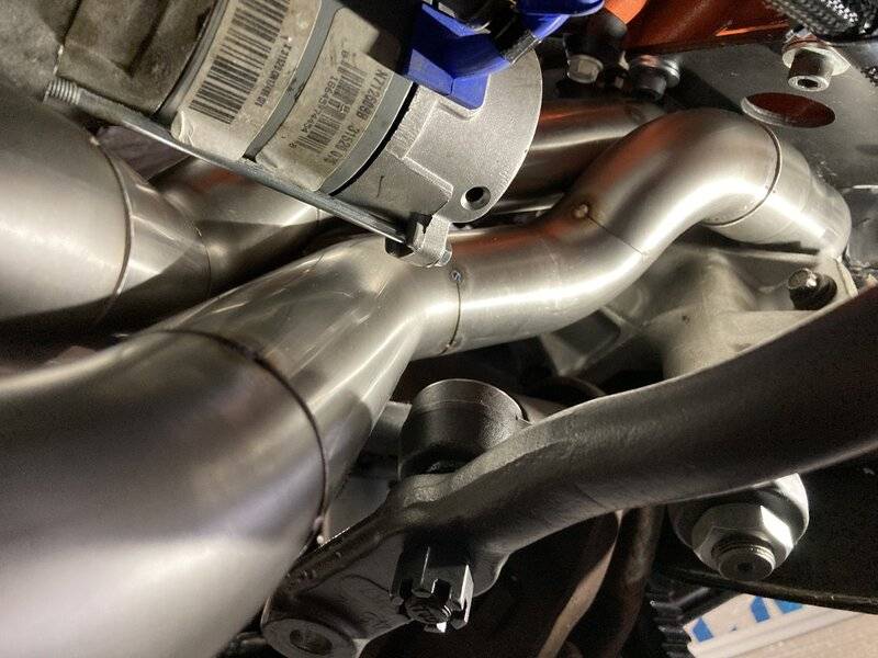

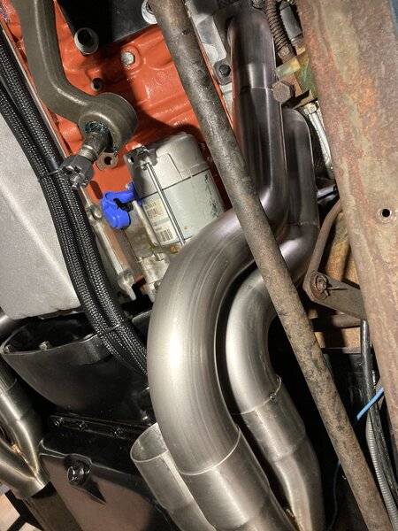

I've been eye balling that. We did the fittings out the side, that gets really tight. I never gave a thought to mounting the filter like you did. I now know what I need to do!
It’s tight but you’ll be happy you did! Side exit doesn’t work well with alternator right there..
Question for you. What's holding in the passenger side water tube in, in this picture? You cut it pretty short and not using the stock tube mount mid block. It was and o-ring fitting, did you tap the housing?
Welded a tab to tube and drilled and tapped 1/4-20 into water pump. Perfect spot for it.

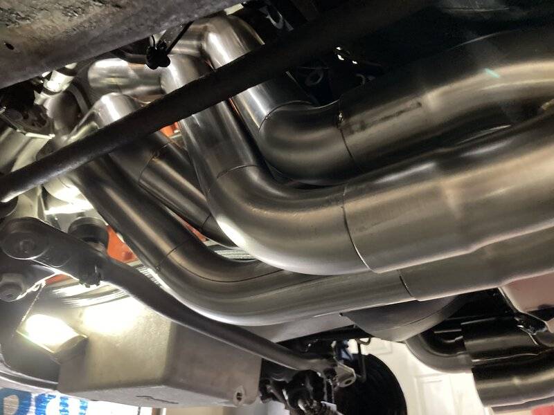

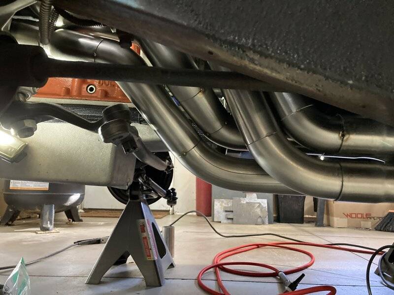

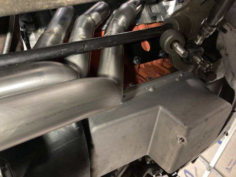

Making progress on the headers. Have one more to go. Also have some track hawk injectors for it now. Ordered a hellcat 525 walboro pump. Going to do some e85.

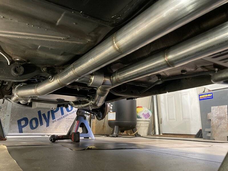

More progress made on the exhaust. Always had X pipe on my cars but I’m going to try H pipe. Will be using Borla pro xs mufflers also.
