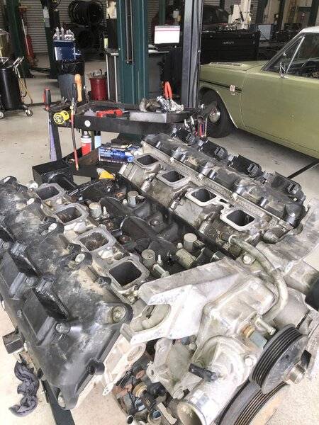

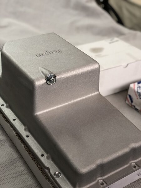

Recently acquired this 2018 truck 6.4l with MDS. Picked it up cheap off Craigslist local to me. Was planning on 392 of some sort to put in my 1968 dart GT. Have been browsing internet for a while looking for either an SRT take out with low miles or just purchasing a crate motor. Ended up with this. I have been slowly putting together the swap items I need. Using Holley mounts, oil pan, terminator max, and Holley swap exhaust manifolds. Everything I got basically horse trading or market place. Plan is to delete MDS and slightly bigger cam. Going to leave my 904 with manual valve body behind it for now. Future plans are 8hp. Question is what cam kit to use? Thanks Ian

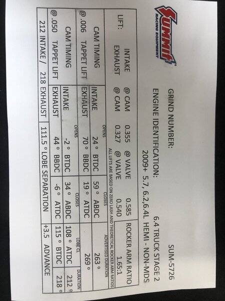

Not going away from LA, just something different. I have a GTS also with LA motor. Appreciate response on cam. Looked at getting SRT cam but stock is very limited seems and price has gone up significantly. Lots of places advertising that BC cam but then it’s a slightly different copy. I’m leaning towards Summit brand cam made most likely by Comp. I have some summit bucks and a balance on a gift card. Found these on market place new still in the box.

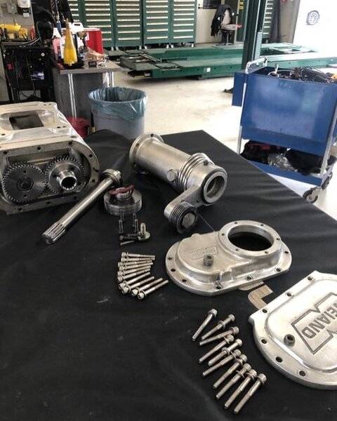

Cool supercharger, is that a B&M 144? What intake? Are you possibly selling?
Nice. I like the "no springs" ability. For what it's worth, the stock 6.4 SRT cam might be a little bigger duration wise but lift seems pretty comparable.
Here's the spec's I have for the SRT 6.4 cam.
Adv duration - 286/288
0.050 duration - 221/225
Lift - 0.571/0.536
LSA - 114
Note that I find specs all over the place so I would take them as a general idea. The fact that Summit cam doesn't need springs follows that it would be smaller to a degree.
Not a fan of locking the cam phaser, but I would guess traction won't be available either way so not sure it makes much difference.

I used a Cam Motion Titan 2 cam in my 5.7 and I'm very happy with it. They have a Titan 2 for the VVT engines also, although the specs are different. Since you are using a stand alone ECU, you can use almost any cam you want. If you aren't afraid of doing some port work, I'd bet you could clean them up with minimal work. That motor will make over 500HP easily with the VVT Titan 2. (.227/.235, .618/.618).
