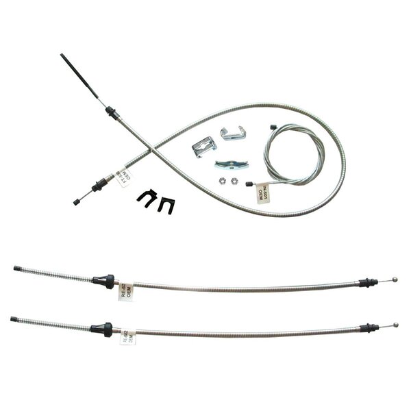

Hi;) :poke:I'm wanting to order a parking brake cable assembly as seen in the picture and ebay link~ and this is the setup that always seems to pop up. Sadly, I didn't take pictures of the parking brake handle assembly before removal. I don't see how the end of the new cable attaches to the parking brake lever? any help would be most appreciated :thankyou:
I have the dash in temporarily, but it will be coming out soon as I figure this part out;)

Your pictures are not correct. Cable lengths appear to be some universal application. The #1 cable (the longest one) attaches to the second hole from the top (your picture is upside down, the top hole is a pivot). The cable attaches to lever with a clevis, not shown in your picture.
After going through a couple years of photos, finally found one that explains the orientation of the parking brake like Murray said. Then I found another front parking brake cable which looks more like I'm looking for but not 100% sure.
Just can't make out what's beside the fresh air tunnel or right below the wiper connector. I'm heading back out to look in my collection of misc parts
Just various googled images, many from the FABO;)
Very good, there you go. That thing hanging down between vent and wiper motor might be a piece of your e-brake. It has the return spring attached to it.
