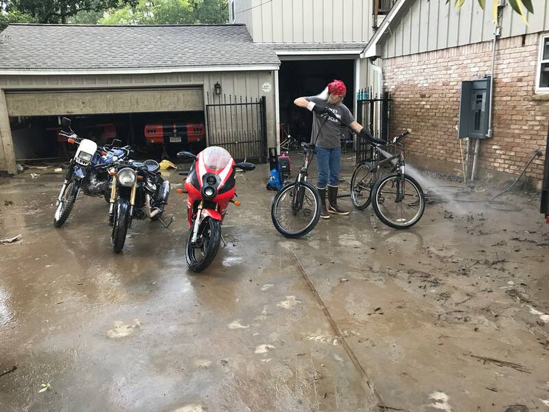

Good luck with the storm. Went through one in Florida a couple years ago. No fun dealing with the aftermath.
Thanks guys;) We were wiped out during Harvey~ it took a couple years to regroup, get another home(which I love). Amazing amount of work!
you can see on my Triumph TR6, the level of the nasty water at the level of the tail lights. Luckily it didn't get into the dash of the triumph, that would have been a nightmare~

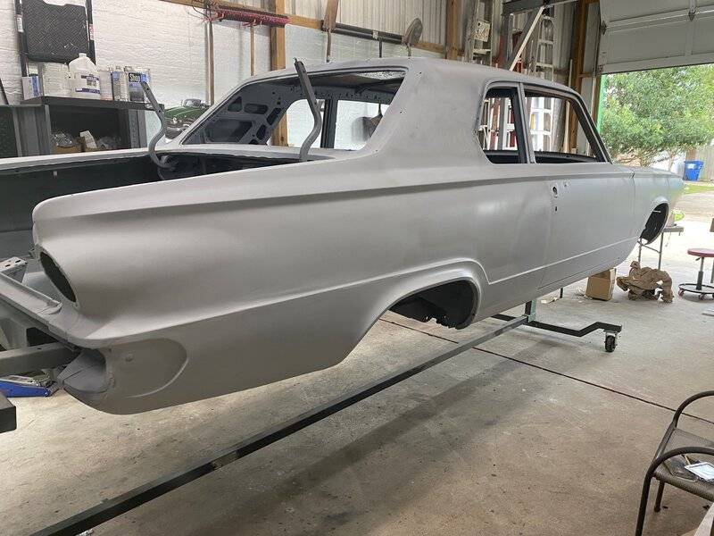

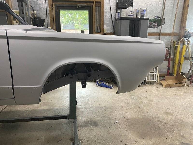

My husband took off early to a meeting, so I was able to start earlier than usual on the body. I had already replaced the right rear lower quarter panel. I'd say the left front fender has been giving me most grief. I wound up blasting the front fenders with my wetblaster a few weeks ago, worked well. The rotisserie made it "easier" to blast; still a mess. I did a mess of body work on the left front, still a ways to go, then I ended shooting high build. Now the temps back up; I don't do heat very well these days.

As for a color, I just about break my neck when I see a color of a car that I may like on my dart. I do like this matte finish Brunswick green~ then with nice decals. No chrome~ I see it in my mind! lol

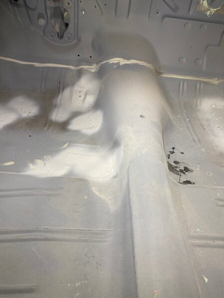

I'm waiting on few other members that could possibly come up with something, but Brewers will eventually have the fiberglass hump, which would solve the finding it now problem! I just worry that a fiberglass may not fit perfectly, whereas metal can be massaged. lol
The pics in gray are my 63 just for a visual (looks like clouds). The floor board in yellow is from an ebay ad for a 70-72 duster. Again, it's just for a visual that if I ever went with a hump I have to massage into place, I know I can do it.

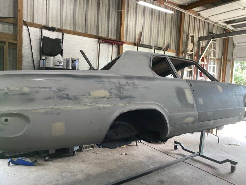

This is going to get repetitive so bear with me~ I'd call this the coats of high build primer~ it's looking straighter, but amazes me how a Low will elude me~ where did you come from my "LOW" life friend! lol Good weather over the next few days! wahoo!

You're doing a good job on it. 2 different colors of the high build will show you high and low spots if you use one color this time and the other color the next, switching back and forth between coats. I learned to feel for them instead of just looking at them. Use the hand you don't write with to lightly skim the panel, with primer dust on your hand. You'll get the hang of it after a little practice. Once you feel a place, take a pencil and lightly mark back and forth across it and then sand across it with a long block. Pencil tracks will stay in the low spots and disappear on the edges of it. Did you find a 4 speed hump?
