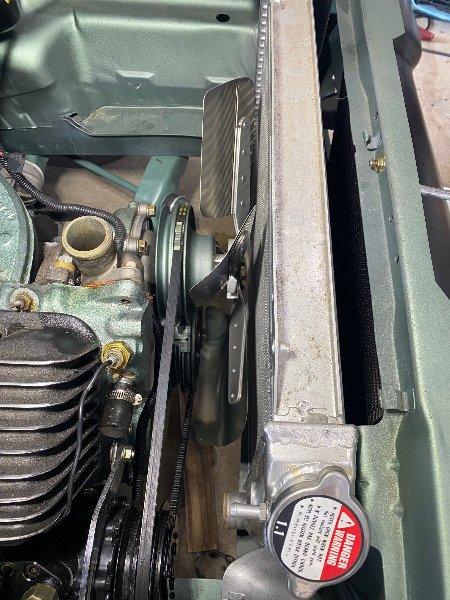

So, here's where I stand on the cooling system. Installed the new water pump~ no big deal on it, the new high flo thermostat got here, but didn't come with a gasket(a gasket in transit), I'm pretty much dealing with a clearance issue between the radiator and crankshaft bolt. I needed a 1 3/8 fan spacer, but I couldn't find one, but found a 1 7/16 spacer original mopar, but put the fan too close to the radiator, I mean it would have worked, but I'd have to pull the radiator to change a belt, so I ordered a 1 1/4" spacer(not here yet). It's just the blades on the new fan are so deep for lack of better description. Then since using the Bronco radiator, just waiting on a hose, then need to order the correct length pipe as I can't find a radiator hose to fit perfectly. So it's just kind of hurry up and wait :lol:

This spacer allowed the fan to touch the crank bolt, not every blade and maybe I could have tweeked each blade, but really don't want to do that.
1 7/16 spacer oem mopar, as said, waiting on a 1 1/4
