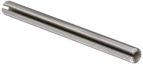

I have 2 pair that have been repaired and they are tight they used a pin like this.......
