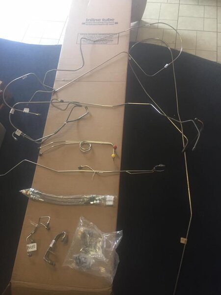

I did the full stainless set from inline tube. If the fronts have an issue, it's likely the rear line does too...
$180 for peace of mind that I don't have to pump the pedal to stop was worth it to me.
