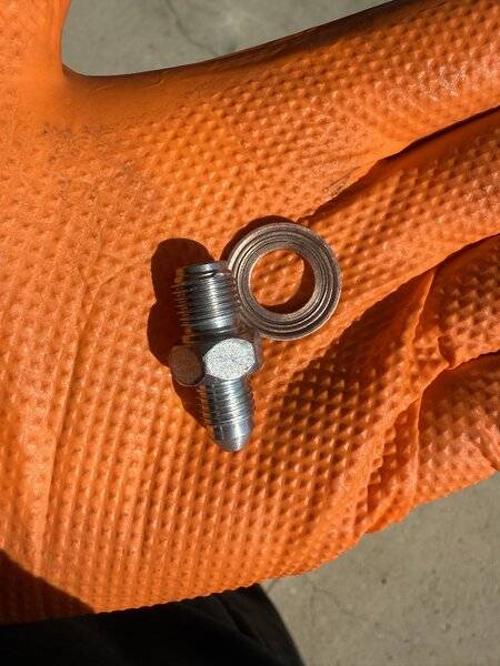

A follow up to my previous post: I did verify the minor leaks at both fittings going into the front wheel cylinders, again as I mentioned that’s probably my fault for not using the copper washers, but when I called and asked inline tube I was told not to use anything that wasn’t included in the new hardware kit, which did not include a copper washers, so I did not use the old ones either, my mistake, regardless the leak was bad enough that I took it apart to inspect and the passenger side wheel cylinder threads are galled pretty badly…
When I installed the new braided brake hoses I cleaned everything and used a tiny bit of anti seize in the threads (enough to maybe kill a lady bug) just enough to help with a smooth threading and made sure none would get into the lines… but the threads are roasted to be sure…
So! Would anyone here happen to have an original front passenger side wheel cylinder they’d be willing the share? 10” drums. I would prefer to keep original parts on the car as I have, if possible. I’ll put up a wanted ad as well. Just figured I’d start here.
1965 Barracuda 10” drums front and back
#P041704 on the wheel cylinder
1-1/8” bore/ soft goods
If I can find a decent donor I plan to clean it up and hone it same as I did here and I’ll just swap in my new soft goods I used to rebuild this one.
Copper washers pictured as well and the fitting into the wheel cylinder. It threaded nicely by hand, but obviously I didn’t do something right.
