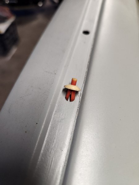

I just went through this and stuffed some of them. They just push through from memory, but you have to be very gentle prying them out. They’re a bit brittle.
If I remember tomorrow I’ll take a pic of one out of the car.

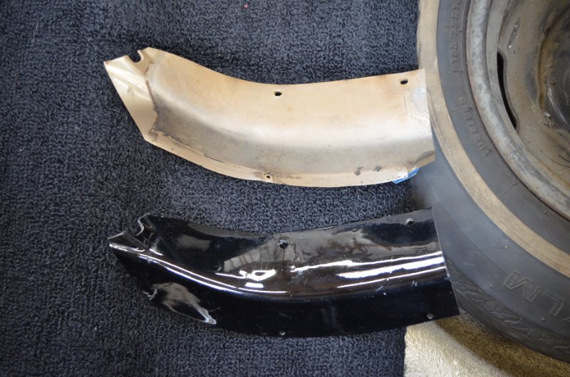

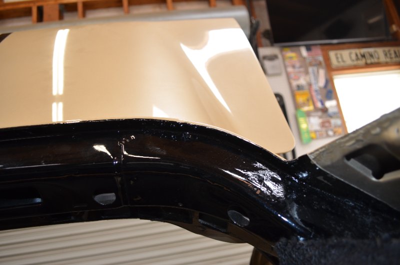

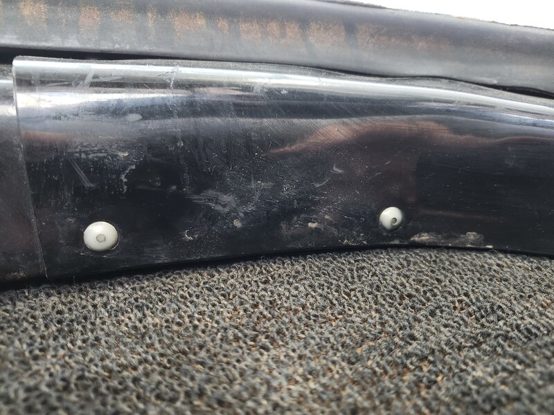

Edit: I just happen to be assembling the rear cargo area and my rear glass is out. There are actually 4 fasteners used the hold the plastic curved piece in place. The two plastic rivets that are visible and two screws that are hidden under the window gasket. Not sure if the two top screws can be removed with the gasket in place. Just be real careful or you will break the plastic and these parts are hard to find and not reproduced. The top picture is without the plastic cover, the middle picture is with the cover held in place. Bottom picture is the old gold molding with broken corner and the black replacement. There are 4 mounting holes on each piece. Its all black so hard to see the holes. Notice the area on the gold piece where the holes were covered by the rubber glass gasket. Those are the two screws you might get out if you can somehow lift the gasket to get to them. I just added the 4th picture with the old gold cover to show the holes for the screws under the gasket better.

Use a punch to pop out the center pin, and then CAREFULLY pry out the plastic rivet. Two thin putty knives work pretty good doing this. As mentioned, those plastic trim elbow pieces are about as strong as a potato chip, so, extreme care needs to be taken removing them. I'm not sure if anyone makes replacement rivets or just the pins. Sometimes those pins get lost when you punch them out into the body. What I did on one car was to use a tiny drill bit to make a short partial hole in the pin, then I used a tiny screw to thread it into that shallow hole. I then grabbed that screw and pulled the pin instead of punching it out. I then just turned the pin over when I re-installed the rivet and trim I was working on so that hole wasn't visible.
I've got to think this through some more. Got the rivets out easily by poking the pins out with a punch, then the plastic part of the rivet came out very easily. The inner trim piece is a different story. Thanks to your help, I realized there are two screws under the window seal. I was able to pull the seal back enough to get a screwdriver on one of the screws and unthread it enough that the head hits the bottom of the glass. Obviously it isn't coming out without the glass being removed, and I'm not anxious to do that. So I drove it back in. Of course that's the corner of the trim that was cracked when I got back there, so I am probably the second person to try to get it out. Maybe that's why the new trim piece was loose when I bought the car! I might be able to loosen the screw enough to snake the trim out, assuming the other screw can be gotten out.

Interesting... My rear glass has never been out but I was able to remove those screws under the window seal without hitting the glass as far as I remember. I can say those holes in the plastic trim I removed are still intact.
