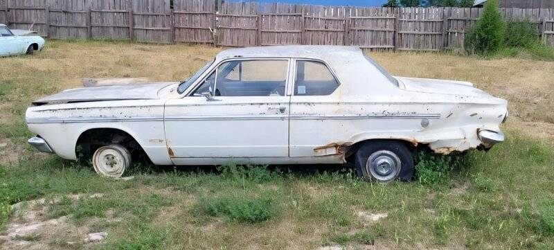

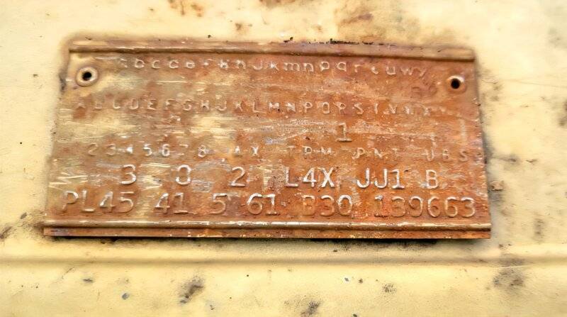

Hi all. A buddy sent this to me from Montana. It looks like a 65 Dart post to me, but this fender tag (sorry for the bad pic) is throwing me off. Also, the fact that it's riveted on. Ideas?
Thanks Jeff. The format on my tag just doesn't look the same as the early A body ones in your linked page does it?
No. I would expect to see numbers for the engine under the Capitol A and B even if there are none anywhere else in that row. Unless 1965 Dart fender tags are different than Barracudas.
A 2 door sedan. 270 model. Yes, it looks like a 65. VIN#?
thanks Mike. Why are there not numbers under the Capital A and B for the engine? Is that a Dart thing?
63 and 64 says "standard engine, no code" 65 engine is under the AB. (like the 66)
QR is where the engine code is on the 63's and 4's. No code, standard engine. Slant 6.
Maybe this old girl is a late 64? Thanks Mike I did not know that.
Wait a cotton pickin' minute here. I wonder if it's not Canadian. The style of tag doesn't match anything in the book. The top row of small letter tags didn't come out until 66.
but the bottom row with AX TRM PNT UBS didn't cone out until 67.
PL45 is Plymouth Fury Low line wagon for 67. 41 is a 318 2 barrel. 5 is torqueflite, 61 is a tire, B30 is production date and the rest is the shipping order #.
Wrong fender tag, That's why it's riveted on instead of screwed on. @Patch
The fender tag came off a '68 Plymouth Fury 2 6 seat station wagon. Gold exterior, black vinyl bench interior, AM radio, 318LA, 904 transmission, a couple of common moldings....
