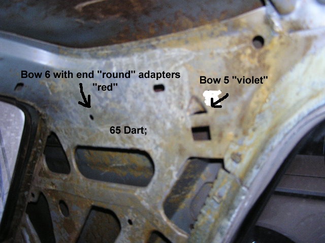

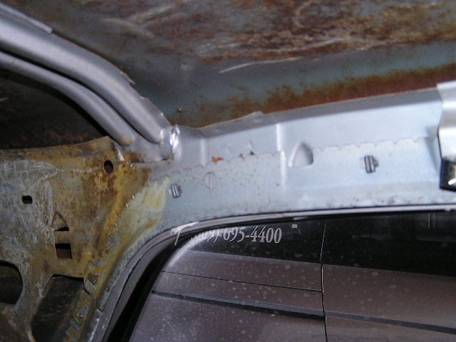

I"m really lost for words now. I haven't gotten a straight answer from any source on the 65 dart 2dr. post headliner.
Some vendors say: hardtops only, 2/4 dr. sedans only, "all"...WTF?
I have 6 bows that came in the trunk of the car, no headliner.
I have a 64 Valiant 2dr. post....I just pulled the headliner to look at the color and bow count.
64 Valiant 2 dr. post: 5 Bows: #1-Brown, #2 Orange, #3Blue, #4 Pink, #5 Violet, and that one gets 6" springs tieing it back to the rear header.
65 Dart: 2dr. post: #1 Brown, #2 ORange, #3 Blue, #4 Pink, #5 no color (different position that #5 on the Valiant). Bow #6 red ends with round end adapters). ties into 2" springs at the rear header.
The C pillar of the Dart is wider than the Valiant.
What a pain. Seems even the vendors who cut the headliners aren't really sure. Some on this list told me, 65 Dart, 2 dr. post....5 bows, not 6. Others say 6 not 5. Hmmmph......

CUDAMARK made the car in a previous post (while my head was still spinning). The Dart is a 6 bow car. Valiant, 5, due to the narrower C pillar.
Now; if I can just see a pict of a 65 Dart post with 5 bows.... What did they do with the 6th?
