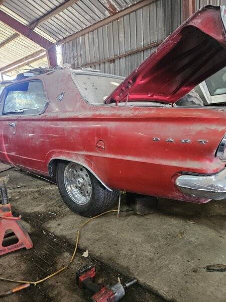

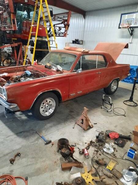

        Almost have our 383 put together for our 65 dart.
        The 383 is 10.27:1, has ported 346 heads, a 704 voodoo with rhoads lifters, edelbrock performer, going to try b body hp manifolds. Likely use our motor plate.
        Also want to put a 8 3/4 out out of a duster in and use one of the front disc b body set ups we have. Likely drill the axles for big pattern.
        It's finally coming together shoe horn comes out very soon. Hope it fits. Heads have been shaved a bunch so hoping that helps make it fit.
        Want to do minitubs sometime but for now...we are tackling plenty. :)
        Thought long and hard about installing the 700hp 440 sitting in the corner instead but decided to use it for our 69 bee.

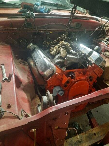

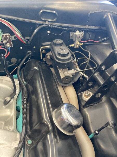

          383 first trial with 72 hp manifolds. Its tight!. Need to make some room on the passenger side. Pulled the master cylinder and column out to help w room.
          We found a 70 duster power steering box and replaced the manual box. Looks like its going to need a 90 degree fitting for the pressure line. We are using 77 aspen spindles and disc brakes with 75 dart ball joints and upper control arms.
          Overhauled a 727 yesterday. It had a blown seal on the back drum. But we had robbed the pump gasket so waiting for parts.
          Master cylinder is sure close to the manifold. We may move it. Anyone use the kit to move the master cylinder over...couldn't hurt? Doesn't appear like it will move it enough to help with the heat.

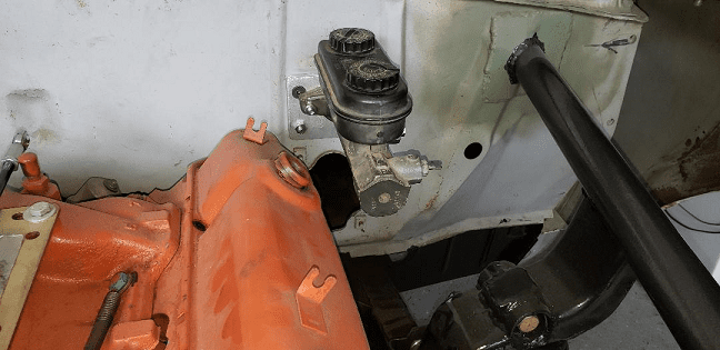

            Wow looking good, is there room for a heat plate to bolt under the master to divert the some of the heat?

              Should be room for a shield. Going to be a lot of heat nearby though. Master cylinder is perhaps 2 inches away from manifold... I thought I had a better picture. Took the master cylinder off and then the engine can go in with both manifolds on. The master cylinder is right above the manifold. Planning on beating back the fenderwell on the passenger side a bit to gain all we can for steering column clearance. Not sure how much the small transmission tunnel will let the 727 move. 20210109_214319.jpg

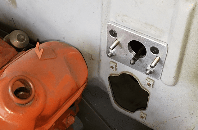

                Have you thought about using a 2-bolt master cylinder? I think they inherently position the master a little higher than a cast iron 4-bolt master.
                Here's a photo of a 2-bolt adapter I made for my 66. While I was at it, I moved it up and over 3/8". I figure ever little bit helps. I'll probably run a heat shield as well.

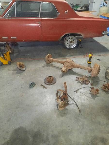

                  Tackling a lot of early a body upgrades with this little car!... Front discs and spindle upgrade, added power steering, changing to 5x 4 1/2 wheels, installing a 8 3/4, have a posi carrier coming for a 741 set of 3.55s we had laying around. Planning on drilling out the rear axle. The wheels showed up today! 15x8s for the back w 5.5" backspacing 255-60r15s for the back. We will make a 1/2 thick wheel shim because the rims rub the leafs. Looks like a 5" backspacing would have been perfect:( Have 3 small places to repair rust on the top of front frame so I made some repair pieces with our brake.
                  Next decision rear disc brakes or rebuild the drums? Not sure...but leaning toward a disc kit from speedway motors. 20210113_133050.jpg
