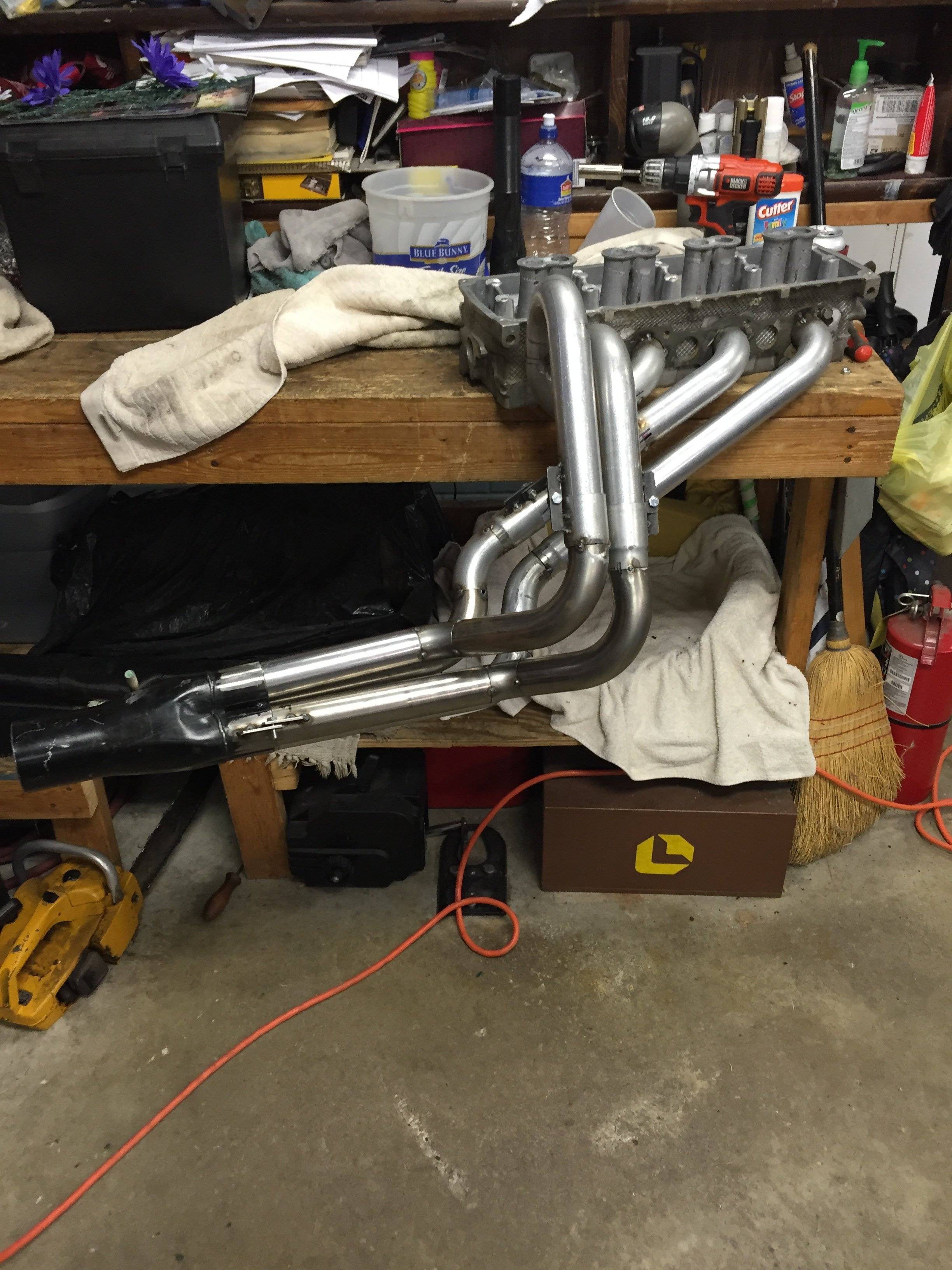

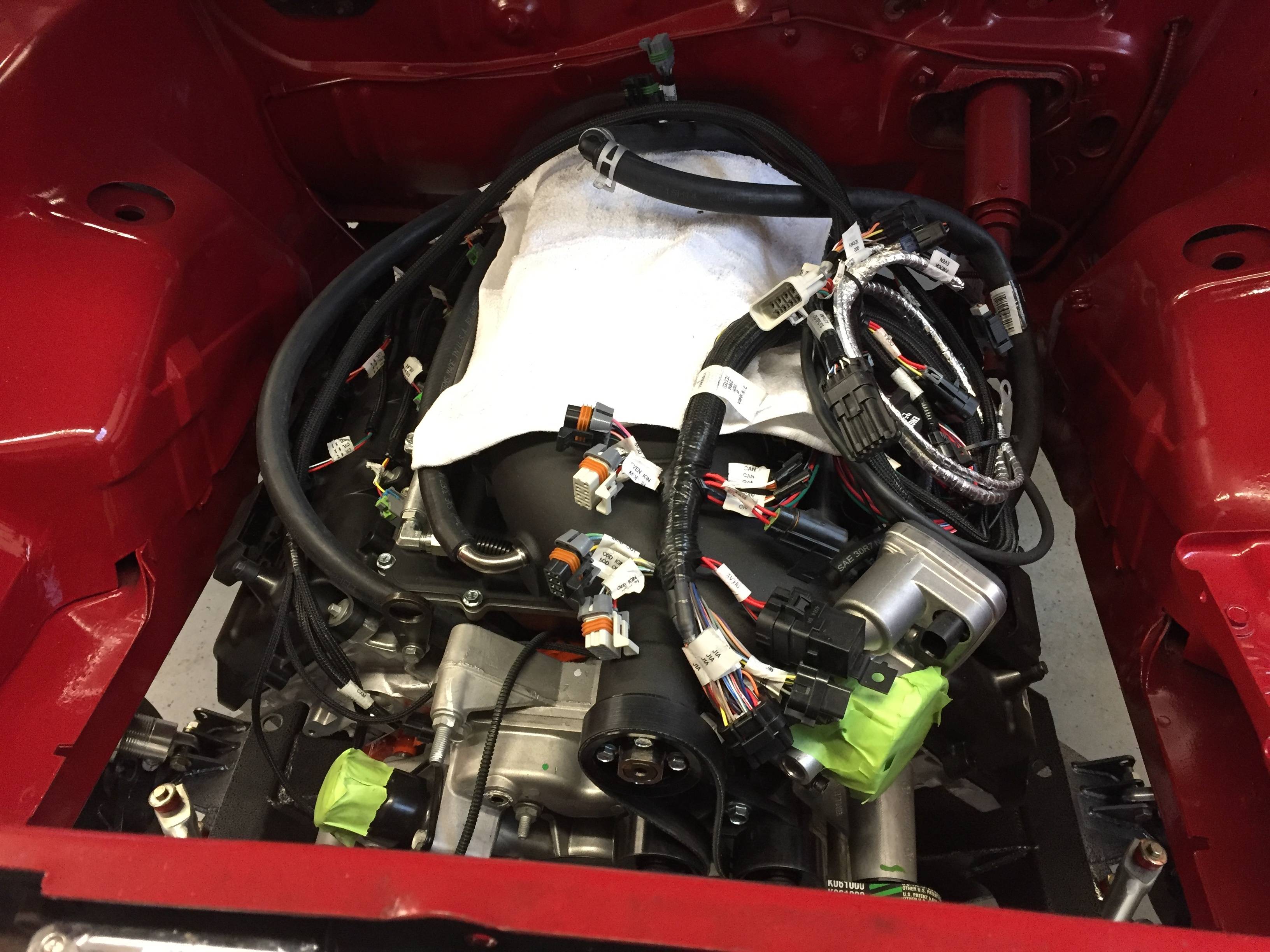

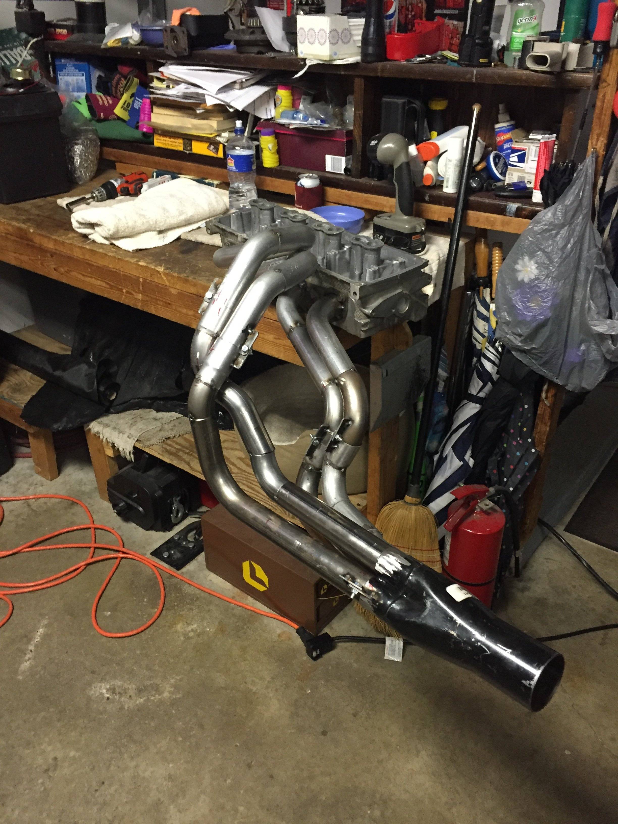

Here is a pic of mine, a 64 Valiant. I am going all stock front end, made my own engine mounts, and last pick is beginning of headers me and a buddy are making. It is very tight and Tincup did a great job on his. It can be done for sure.
Milodon pan and I'll take some more pics later in the week. Here are a few of the finished headers.
Looks like some looooong primary tubes.....partial fenderwell? If this is going to be a street ride, you might want to rethink the slip connector, through mufflers, they will likely leak like a siv.
I admire your gumption, IMO, this install has a degree a difficulty of 15 on a scale of 10
Mopar to ya'
Denny
Yupp, they are long, lol! Two tubes each side goes through fenderwells. Unfortunately I have to put the top half of the headers on each head and then install the head.....but I am going to seal the crap out of them. Nothing ideal but I like my odds of 15 difficulty on 10 scale, haha! I do have on other idea however if this does leak a lot. Thanks Chuck
