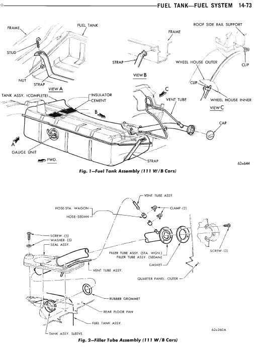

so dropped the tank on my 66 dart and its not clear to me how/where the vent tube for the filler neck attaches to the tank. i think the previous owner had it jammed into the filler neck grommet, but that doesn't look or sound right.
any ideas? thanks,

Here you go:
