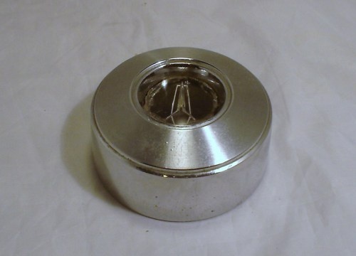

Can you post a photo? It must have a way to remove the center cap on the steering wheel. On my 65 Newport, it is a chrome "can". You turn it 1/4 turn ccw so the spring "fingers" align with the slot, then it pulls off. I think my 65 Dart is similar. Forgot how it was on my 69 Dart, but recall the same.
Once the cap is off, you see screws that attach the horn ring, and under that the main bolt for the steering column. Of course, you'll need a steering wheel puller, but those are cheap at Harbor Freight. I once made one. The steering wheels have always pulled off easy for me.
