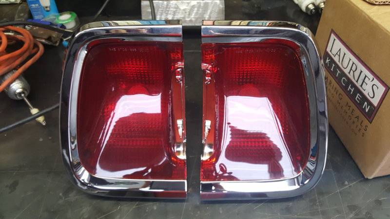

Finally finished piecing some 69 taillights together. The housings were from laysons sold to me by a fabo member. Lenses i got used from Cosgig, and micropolished to look like new and the trim euscutcheons i got on sale from PG not shown in pix. Also got new lens gaskets from Jim fillmore at DMT.
